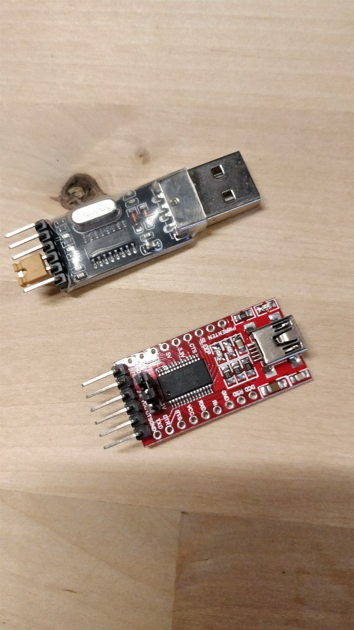

Yes im familiar with compiling no worries, my question was which version on the release page? There are 8 different iterations
Also which dongle should I use out of these 2..
USB TTL or
FTDi 232 ?
USB TTL or
FTDi 232 ?
