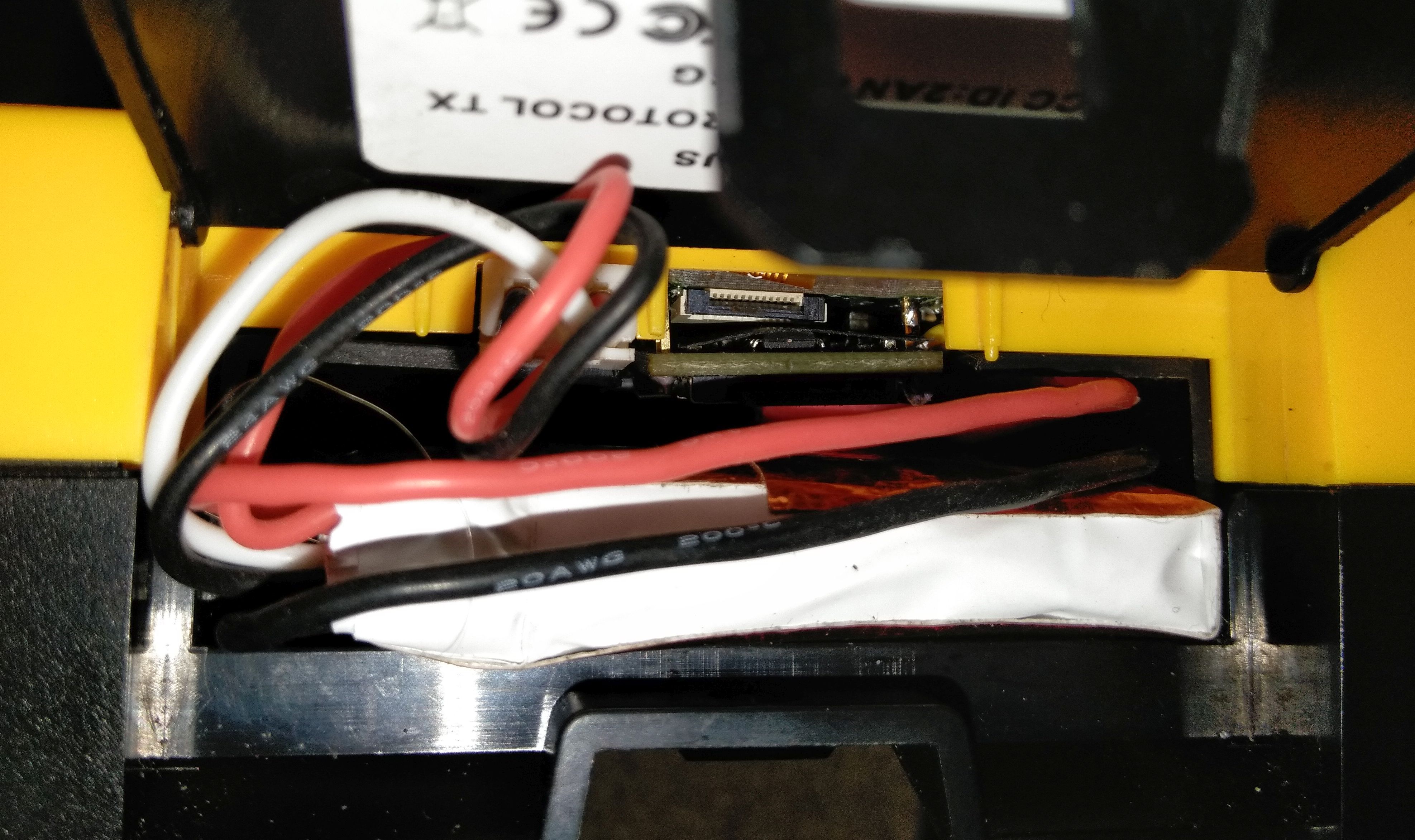

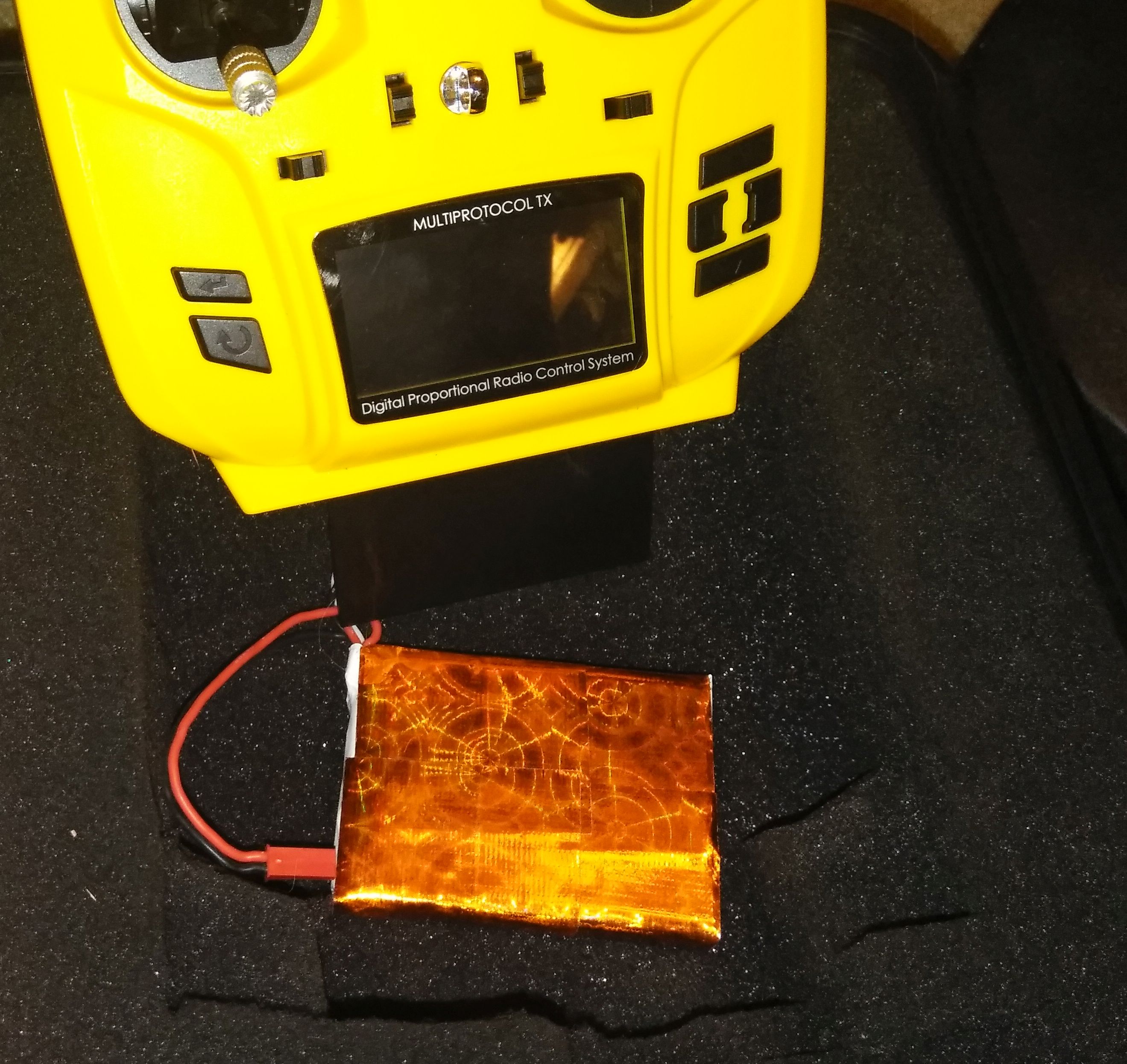

Ok, look at my post here:
www.deviationtx.com/forum/6-general-disc...itter?start=80#70401
The 1800mah 2S HK battery fits the area and allow for maximum capacity. You have to doctor the pack as shown by clipping those massive
wires from the tabs. Just carefully disassemble the pack. You do need to have some replacement shrink wrap available. I use an angle
cutters and cut the large wires off the solder "blobs" at the tabs. It's to much work to desolder and then resolder. Besides the other wires
will flop off the tabs when you desolder. Just carefully clip the big wires off. Reassemble the pack and you can reapply some of the foam
tape to pad and insulate against a dead short. Apply shrink wrap and your done. I drain my packs to storage capacity when I mess with them
to avoid "vaporization" if I do something stupid during a battery mod and suggest anyone else do the same. Check the V and charge up the
pack. Can still do balance charging etc. Kurt

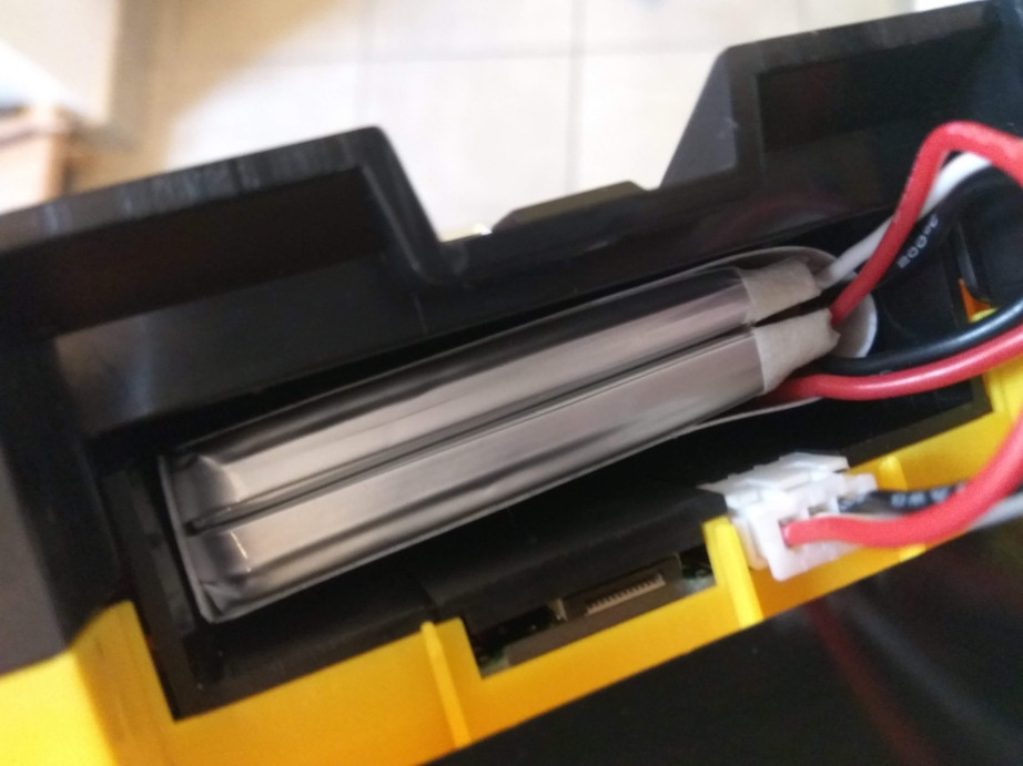

My jumper V2 Plus has a 2600 mah 2 cell made from two $5 power banks bought locally from Five Below. The ultra thin version has a 2600 mah 1S in it that is almost perfect in size except for the little insets in the top of the battery box which are easily removed. The added benefit is that the assembled pack in a 2S configuration is quite a bit thinner than others I have tried which makes it much easier to get to my dfplayer voice card.
