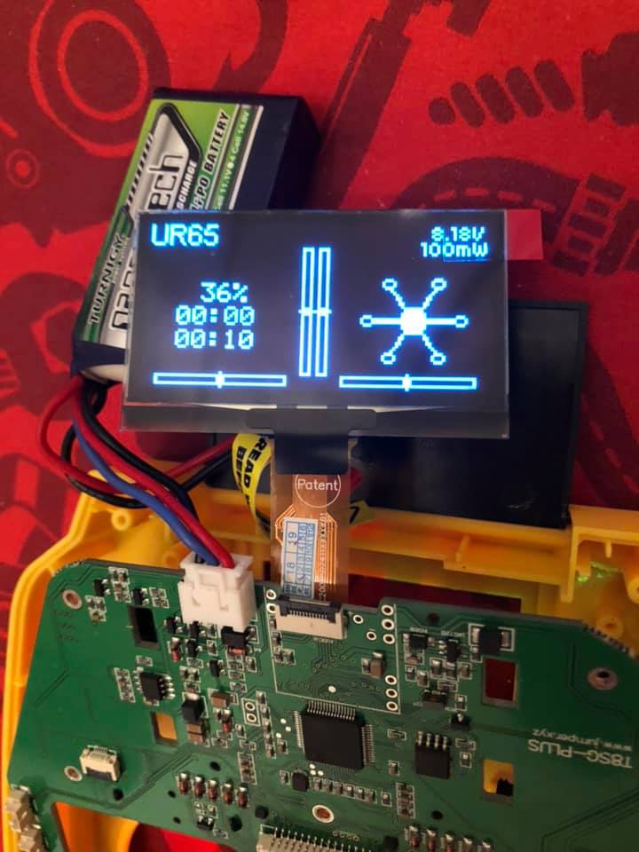

Fixed, I had the corrupt drivers on the pc but in the meantime I burned the OLED display, fortunately in 3 days from China I arrived
