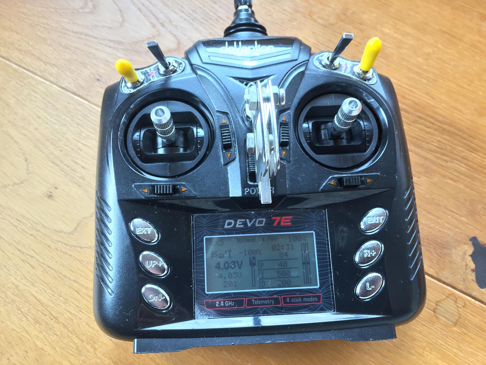

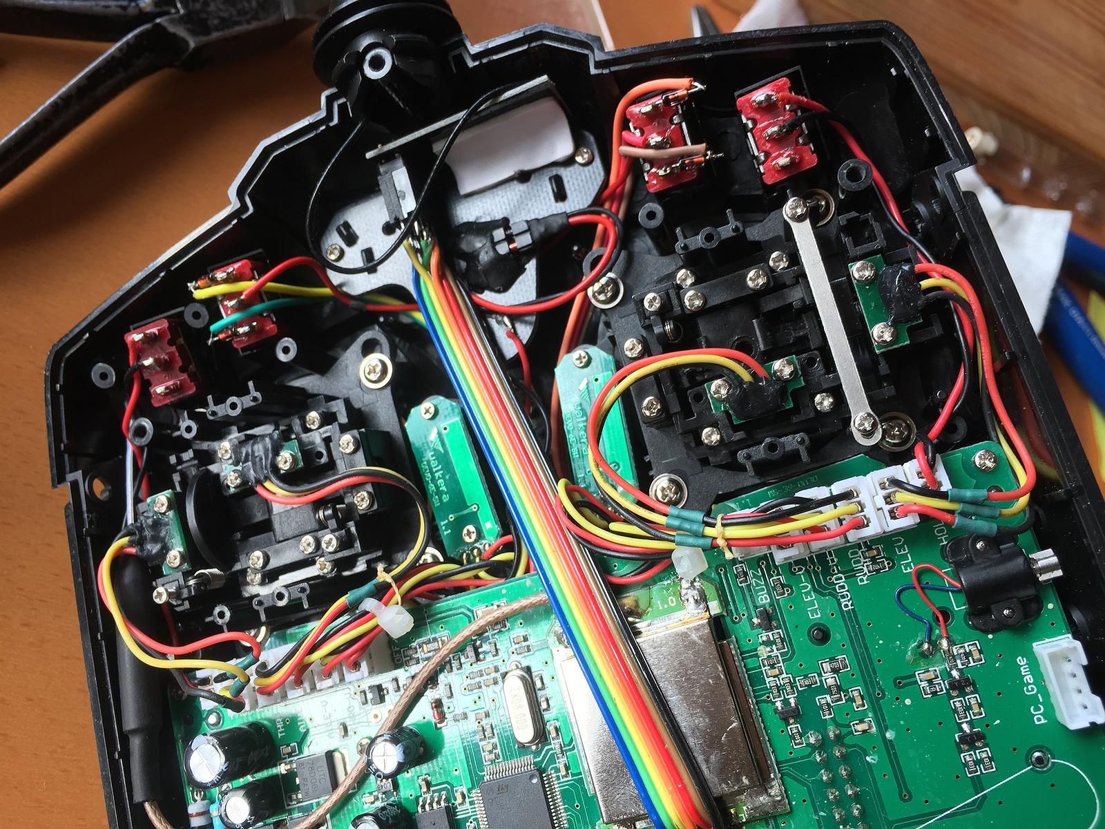

Hi Yets, I ordered the Jumper V2 Hall Gimbals from Banggood: www.banggood.com/Jumper-V2-Hall-Gimbal-f...itter-p-1370924.html
Placing them into my Devo 7E required some cutting and drilling, but the end result looks fine.
I couldn't be more happy with how they perform. Especially the hysteresis on the throttle stick of the old gimbals annoyed me quite a lot. Of course totally gone with the hall gimbals :)
