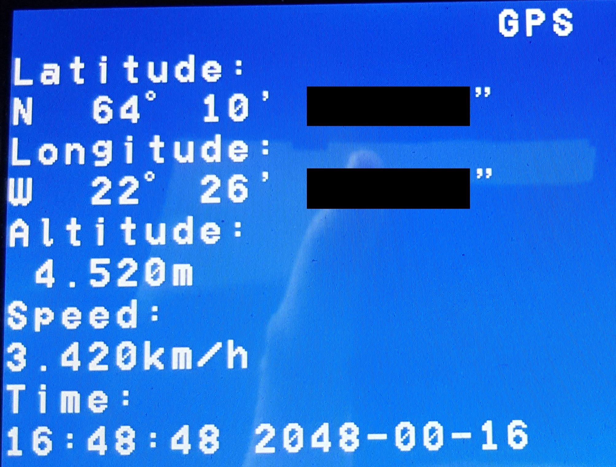

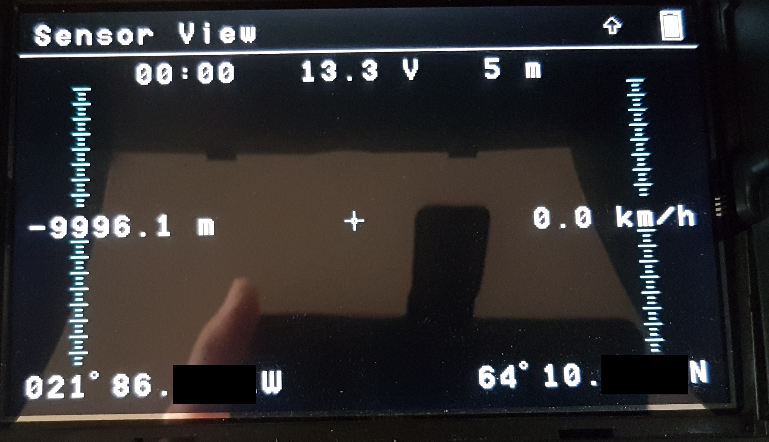

I am testing on a QR-X350 Pro that I have replaced the RX703A with a RX705 receiver to get telemetry. I have attached two screenshot showing the difference in GPS coordinates for Walkera and Deviation. I blacked out a portion of the GPS coordinates for privacy reasons.

21 Jan 2019 16:41 - 21 Jan 2019 16:46 #72451 by vlad_vy
Replied by vlad_vy on topic Problems with Devo F12E nightly builds
It looks like QR-X350 Pro GPS sensor use format DD.DDDDD, not DD MM.MM
Longitude can't be 21° 86.xxxx but can be 21.86xxxx
I tested it with Walkera telemetry module WK-CTL01-D and Walkera GPS sensor, and I have correct GPS coordinates. So, I think QR-X350 Pro GPS sensor is not intended for Devo telemetry.
