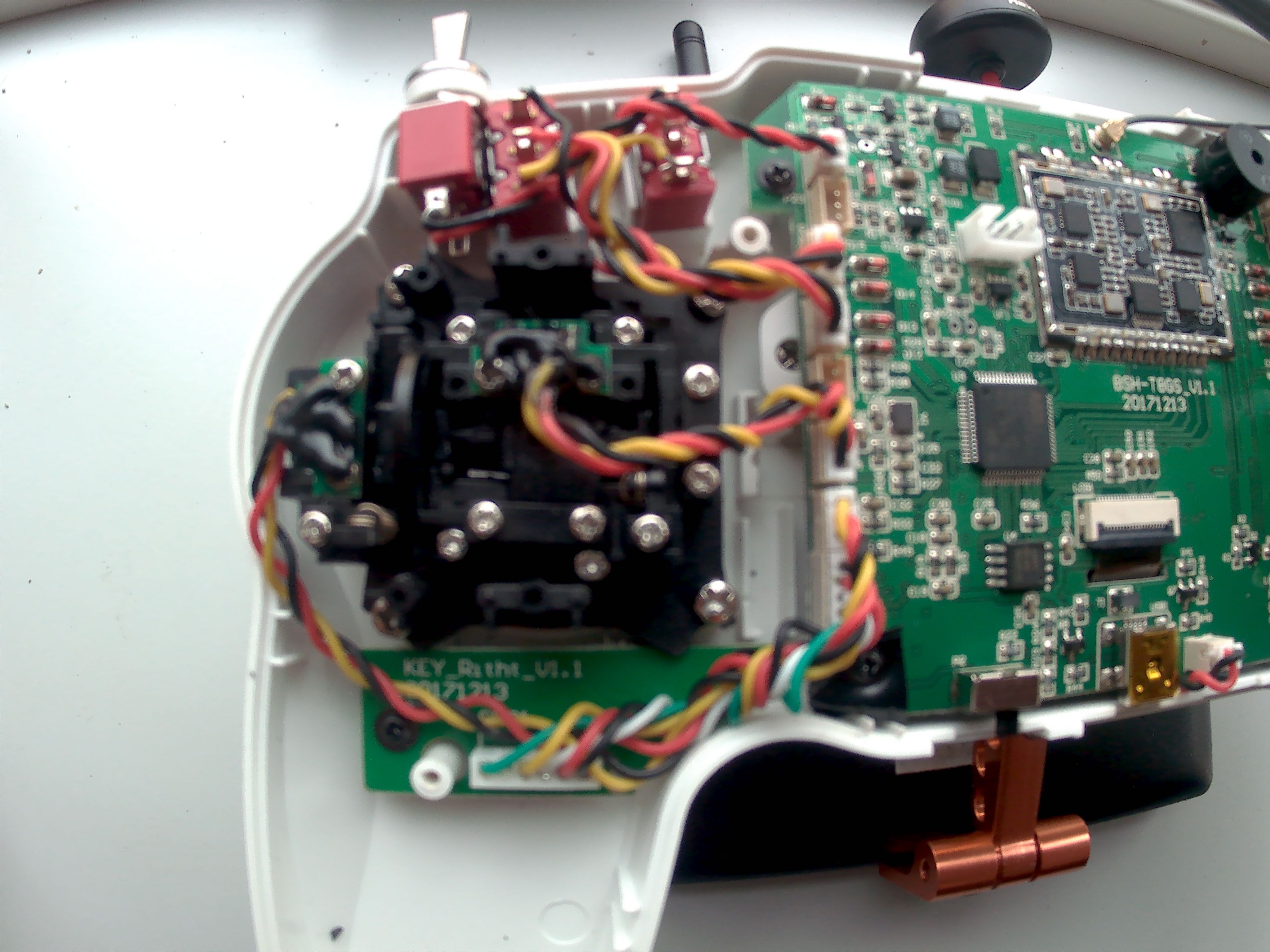

On mine it was a screw holding the pcb, that shorted out two tracks.
If you remove the back, then it is the screw on the bottom left(a black screw). i put tape under mine.
I will try and upload a picture.
Another thing, that can do this is if some of the pots or gimbals are storted out. It is easy to find out, just pull out all the plugs to the gimbals and pots.
