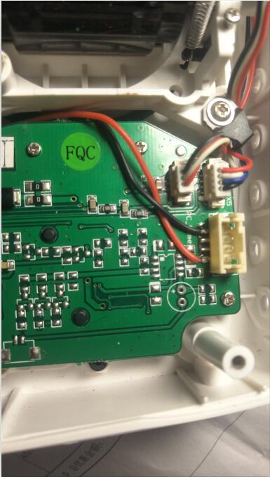

I took ppm output from "the trainer on when unplugged" picture from the guide for voice module. As for power 2 choices i can think of

The picture for internal installation shows the correct places to wire to the trainer plug.
Do not take power from the 12v out at the top. The processor will slow down. everything will be delayed or just not work voice takes extra 5 seconds and may not play at all been there done that not a good power source. I listed the two options those are the choices i am aware of
There is no existing speaker under the grill just an empty hole. Yes its safe to renove the board but there is no need. just take out enof screws to make room to slide the speaker under

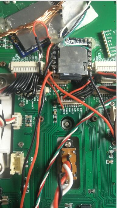

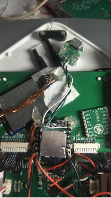

- 52dgj
- Posts: 56
10 May 2019 16:31 #74273
by 52dgj
Replied by 52dgj on topic F12E and xms couple questions
This is my installation method including power supply mode, I have not found any problems at present.
