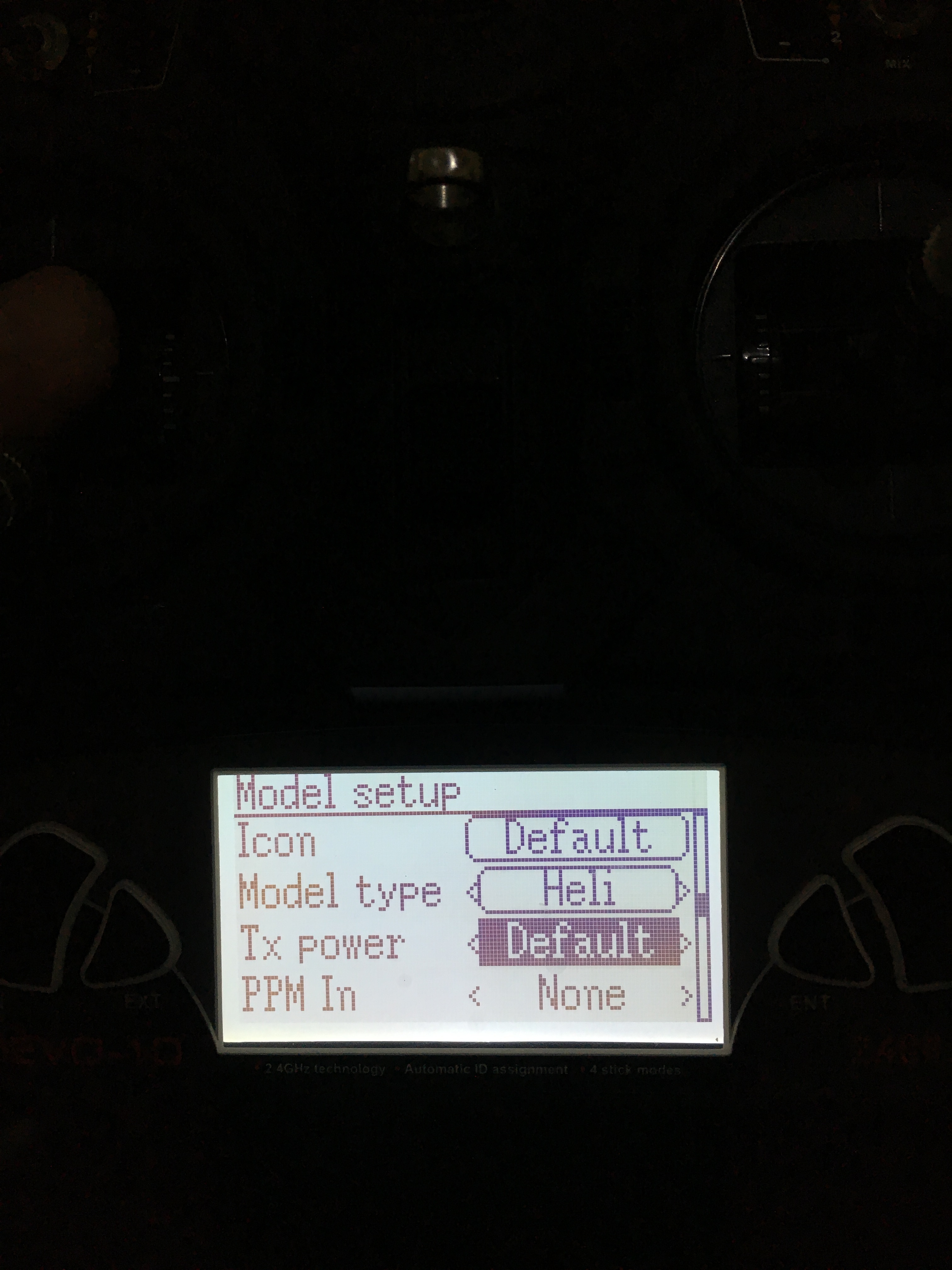

Hi all,
I just installed a 4-in1 module in my Devo 10.
The Devo 10 has Deviation 5.0.0 installed.
The module works because all the protocols are without asterisks and I have actually loaded some protocols like KN, Bayangtoys and CG023 to bind and fly successfully with some quads and helis.
But my question is why is the TX power restricted to default power (150mW) for some protocols but not restricted for other protocols? Specifically, after S-HFSS protocol, the TX jumps to default power output for what looks like the NRF24 module. (I am unable to change power setting).
Is there a problem with the module? Or am I missing something in deviation? I’d like to reduce TX power as it’s hard on my batteries at max output.
Any help and input would be helpful and most appreciated.
Thanks in advance.

Tried again the latest nightly (19/3/19). Same result for the TX power at default (cannot change power but now shows in model screen; 100mW for the model instead of 150mW) and the weird button issue even after loading back the backed up files.
Strange. Even tried a Devo 10-v5.0.0-9d11a9c with same results as above.

Looking at the code the only reason Default is displayed on the Model Setup page is that the radio does not have a PA. The has_pa-nrf24l01 line does not have a semicolon at the beginning? Do you see the same behavior when starting with a new model and selecting an nrf24l01 protocol? If so please post your tx.ini and hardware.ini. I can load them on my devo10 and see if I get the same behavior.
