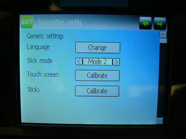

button navigation ? was created by Birdman

What firmware release do you use? With v5.0 release first press on "UP" or "DN" button will select "Exit" button and next press will navigate on screen buttons. To deselect buttons, press "EXT" button, then you can navigate pages by "L" and "R" buttons. With nightly builds it can be different.

Replied by Birdman on topic button navigation ?
5 with latest protocols.
Yes i understand and can do what your saying but what i am asking is how do i "scroll up/down" to other settings.
To buzzer lcd and timer settings?
high lighted box never goes across to scroll "up/down" arrows on far right side of page.
Last edit: 07 Oct 2019 04:20 by Birdman.
07 Oct 2019 04:20 #75199
Replied by vlad_vy on topic button navigation ?
Scroll down by long press "DN" button, scroll up by long press "UP" button.
transmitter config opens on "generic settings" how do i scroll down to buzzer settings, lcd settings and timer settings? which are all in same window but you need to scroll down to see them
ok, that works, much appreciated
