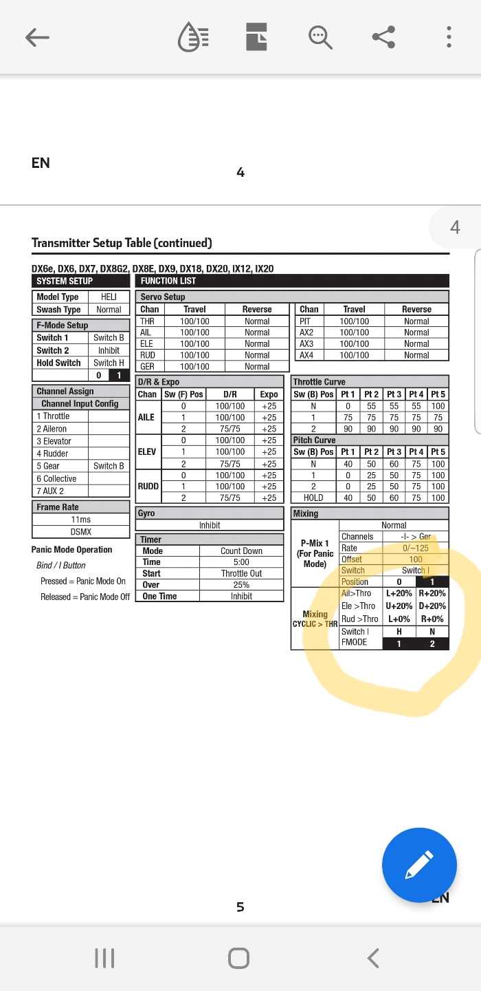

Blade 150S cyclic to throttle mixing was created by Timbo77

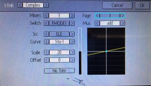

you might be able to do this with a complex mixer set up on Ele and Ail and add 20% to the throttle channel.

Thanks, I will give it a try, I was trying to set aileron and elevator to cyclic 1, 2 respectively, it then gives you throttle cyclic - aleron and elevator mixing options prior to virtual channels. I then set DR/expo but no where can I see how to mix 20% throttle. Plus, the cyclic was all wonky and nothing moved correct.

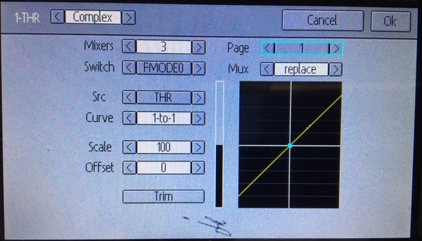

This is my .ini for my 150S and it works fine, TH on G, Panic (Recovery) on H, Flight modes (3) on D and throttle swash mixing on.
