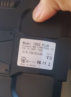

Ok I tried that about ten times and nothing
here is a picture of the back of my transmitter.
06 May 2020 16:00 - 06 May 2020 16:02 #76246
Replied by vlad_vy on topic Jumper T8SG Plus V3 Carbon
With nightly builds 2020-05-05 firmware?
Last edit: 06 May 2020 16:02 by vlad_vy.
