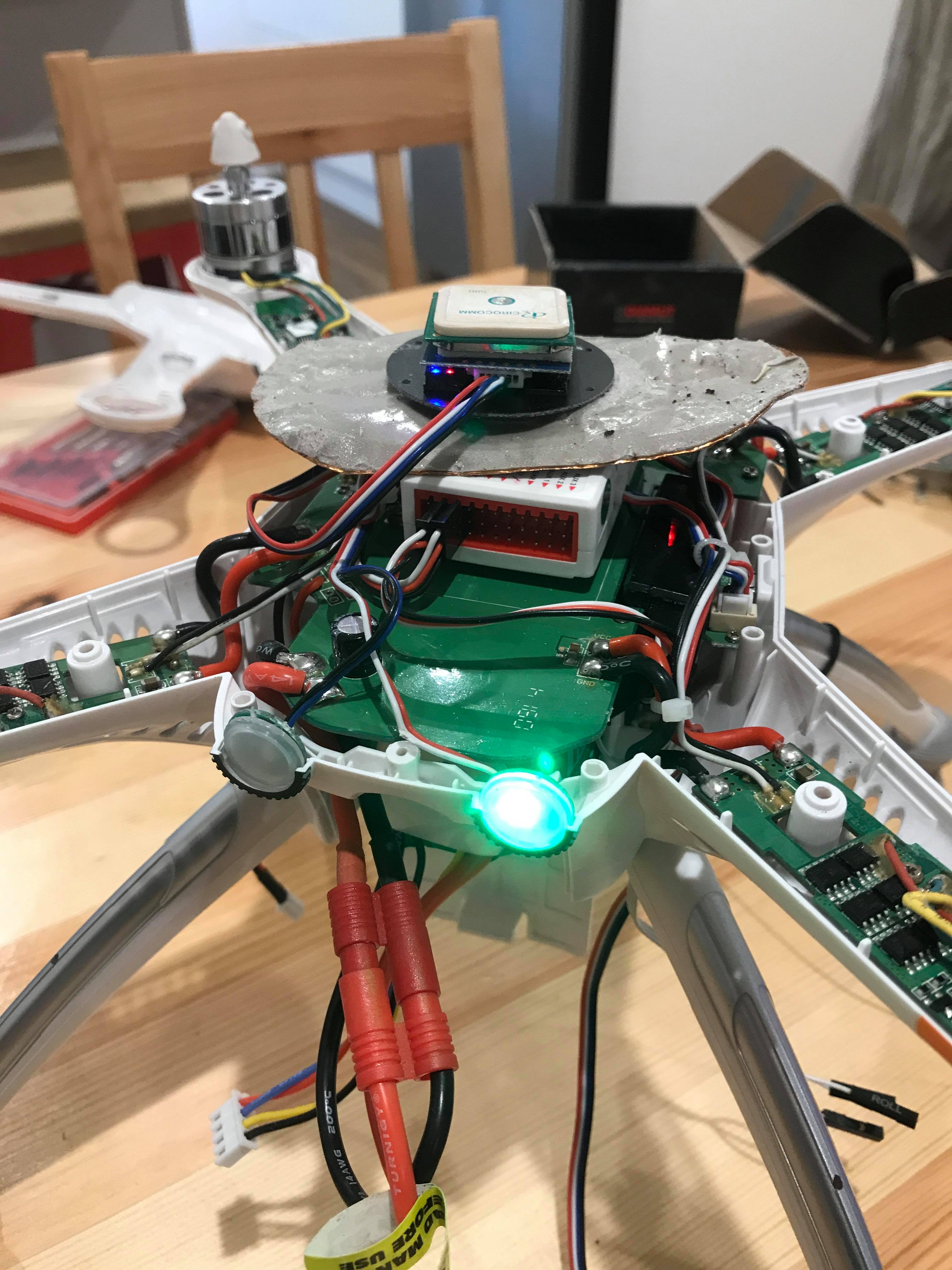

Hello Everyone!
I have Walkera QR X350Pro with DEVO10. I am running 350_V1_5.bin with X350 Pro Devo 10.bin and X350pro-Walkera-Original.param, deviation-devo10-v5.0.0.dfu. The Copter binds to the RC but I can`t neither enter Calibration Mode nor I can start the motors.
The left green LED stop flashing after the RC binds to the copter and I get solid red light from the transmitter. Then the right green LED start flashing 2 signals in set (some times 3 signals). What does this signals mean?
The GPS module flashed blue and red LEDs.
Thank you!
Thank you!

The right LED is telling you how many satellites it has found. There is nothing mysterious about it if you actually read the manual. It tells you how to calibrate, what all the LED's mean, how to lock and unlock the motors.

The DEVO10 is running DeviationTX v5.0.0 I will bring it back to the original later today.
I know about the satellite signal and all, but in the manual it says that it is 4 flashes or more, not only 2 or 3 as mine does.
When I move the sticks to start calibration the left LED does not start flashing as per manual - nothing actually happens.
When I move the sticks to unlock the motors as per manual - nothing happens either - only the mysterious 2 flashes from the right LED...
