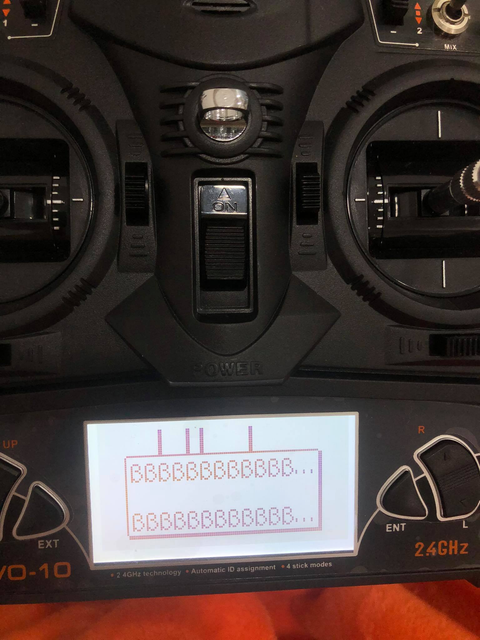

So i was going to upgrade my devo10 using the dfuse tool but now when i start my devo 10, it keeps beeping with a bunch of b's on display. Can anyone help?

If you use Deviation firmware, try to rewrite transmitter filesystem (USB drive) from firmware archive.

"Connect transmitter to computer, format transmitter USB drive and rewrite filesystem. Use "Safely Remove Hardware" after writing filesystem. " i found this in the forum. But the transmitter doesnt show up under This PC. Any other options i can format it?

Power off transmitter, press ENT button and power on, you will see USB symbol on the screen, connect to computer and look for removable drive.
