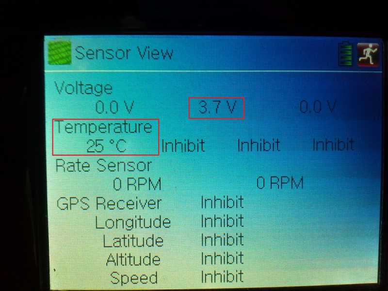

Ok, so I was able to figure out how to read temperature from the telemetry as well now.
The Devo seems to support 3 voltage values and 4 temperatures over telemetry. The odd thing is that the Devo shows the MiniCP/Ladybird voltage as in the middle position, yet from what I see in the protocol it should be in the 3rd position, so there is no question I don't understand all of the bytes in the telemetry packet yet.
