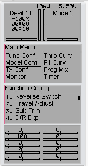

07 Oct 2012 09:53 - 07 Oct 2012 11:58 #2022
by suvsuv
What function should be put in D10's main menu was created by suvsuv

Due to the resolution limitation. D10's gui layout can not be the same as D8. And I would like to stick to factory-layout with some more flexibility

PB, I agree with you points. However , I thought the devo8's GUI is more suitable for elite, so I want to deliver a GUI for newbie who are familiar with JR/Walkera's TX menu style. Regardless of GUIs, they are all from your great framework with almost the same functionalitise, the more GUI, the better for devo-users
