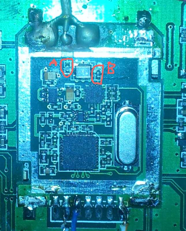

06 Feb 2013 12:51 #6081 by Xermalk
Replied by Xermalk on topic Devo7e work
So, i managed to get the shield of. Wasn't the easiest job though.
As you can see on my image there was a insane amount of solder on the antenna corner so my iron could not melt it there.
I had to cut of that tab and leave it in place.
Is it the component at A that needs to be bridged if one wants to increase the transmit power?
RandMental wrote: I don’t suggest it will damage the TX, but if the power stage, its power supply and antenna matching are not designed for levels above 10dBm/10mW, we could generate serious noise (harmonics) all over the band and have signal integrity problems. A combination of over modulation, high power supply impedance and low battery voltage at these >10dBm levels will result in reduced range and an unreliable signal. (and then Deviation firmware gets blamed - sorry guys, some hard earned Amateur Radio RF experience coming through here)
Im guessing lowering the transmit power setting in deviation would avoid this if its the case? Im asking as its very unlikely ill be able to bridge these tiny components in a way that it can easily be undone.
Worst case id have to remove the diode and bridge the gap with solder.

06 Feb 2013 13:49 #6082 by PhracturedBlue
Replied by PhracturedBlue on topic Devo7e work
SadSack wrote:

06 Feb 2013 13:57 - 06 Feb 2013 13:57 #6083 by PhracturedBlue
This is the diode that needs to be shorted:
I haven't tried it yet though, so no guarantees. Worst case is you need to replace it with an 8s module.
Last edit: 06 Feb 2013 13:57 by PhracturedBlue.
06 Feb 2013 14:26 #6084 by Xermalk
Right, well that screws up my plan.
Going to have to figure out what to do now. As theres just no room around those tiny components there.
And the big xtal dosnt help as it makes them harder to reach.
Seems the only way might be to remove the diode with a Surgical knife and then somehow bridge it. Either with solder, or some form of electrically conductive glue or paint.
