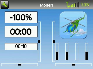

When did the main page layout change?
09 Feb 2013 19:43 - 09 Feb 2013 19:44 #6180
When did the main page layout change? was created by FDR
Last edit: 09 Feb 2013 19:44 by FDR.
09 Feb 2013 20:26 #6182
Replied by PhracturedBlue on topic When did the main page layout change?
It wasn't done on purpose by me. I agree with you, that it doesn't look right. Maybe domcars adjusted it to allow displaying really big timer values. I'll dig into it.

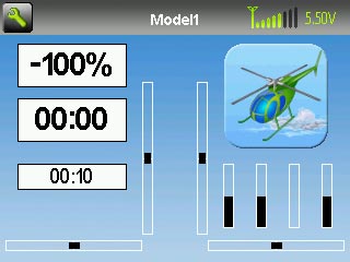

I changed :
-#define BOX_W 100
+#define BOX_W 113
In pages/320x240x16/main_config.c
If we want to keep the previous width, we have to denied the permanent timer display on the four top Boxes main page ...
Replied by domcars0 on topic When did the main page layout change?
That is ... This is because the permanent timer may have a value of 99:59:59...PhracturedBlue wrote: Maybe domcars adjusted it to allow displaying really big timer values. I'll dig into it.
I changed :
-#define BOX_W 100
+#define BOX_W 113
Last edit: 09 Feb 2013 21:38 by domcars0.
09 Feb 2013 21:34 #6184
Replied by FDR on topic When did the main page layout change?
OK, I thought about that too, but why did the bars move? Do they use the same BOX_W?
BTW why did you choose such a nice prime number?
Anyway, no problem, just need to move them more to the edges...

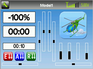

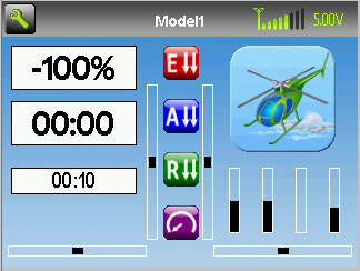

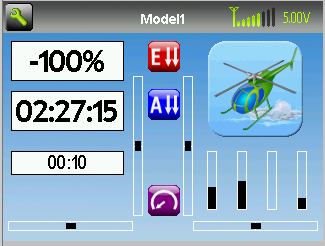

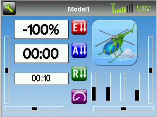

I've recentered/replaced the Boxes and GraphBars on the 320x240x16 main page.
I think now it's nice again
@PB: You may take a look on my repository, I've coded the button to reset the permanent timer.
Last edit: 09 Feb 2013 23:07 by domcars0.
10 Feb 2013 06:37 #6195
did you test this with 'outer' trims? The boxes are too close to the toggles. if you move the bars and boxes a little toward sthe outside for this case, I think it will be good.
