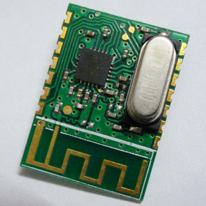

I am going to mod another Devo and give the 7E to my son. So I am looking at this transceiver module. Do you think it will work in the same way as the v911 module or maybe even better?
If so how would you do with the antenna?

I've used that module. It is basically the same as the one in the Hubsan X4. The range is significantly less than the V911 module though. you want the '500m A7105' module if you want similar range as the v911 module (like this):
www.ebay.com/itm/A7105-500m-wireless-tra...&hash=item4607bf6bda
That said, the one you lined is generally fine for micros if you don't fly in a big field.
