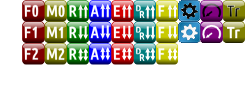

20 Apr 2013 16:05 #9076 by PhracturedBlue
Replied by PhracturedBlue on topic toggle.bmp needs a 'standard'
I've now updated the icons and sorted out the controls for the devo10.
Here is the icon set for devo8:
And here it is for the devo10:
Regardless of whether the icons are good, they are at least consistent. Unless anyone sees any issues, this should be a stable set usable for the future.
20 Apr 2013 17:07 - 20 Apr 2013 17:14 #9079 by vlad_vy
Replied by vlad_vy on topic toggle.bmp needs a 'standard'
After save model, FMode2 icon is cleared to '?'. Before saving: F0, F1, F2. After reload model: F0, F1, '?'.
Last edit: 20 Apr 2013 17:14 by vlad_vy.
20 Apr 2013 18:12 #9080 by PhracturedBlue
Should be fixed now
22 Apr 2013 06:44 - 23 Apr 2013 08:37 #9116 by vlad_vy
As I can see, default icon assignment at emu_devo8 is incorrect:
ELE DR1 = M0
AIL DR1 = F0
RUDD DR1 = R↑↑
GEAR1 = DR↑↑
Last edit: 23 Apr 2013 08:37 by vlad_vy.

18 Nov 2016 10:56 #56001 by bjr981s
Replied by bjr981s on topic toggle.bmp needs a 'standard'
PhracturedBlue wrote: I've now updated the icons and sorted out the controls for the devo10.
These are great and I have been using them s I am building model configs on me Devo 12S.
I have both Multi modules 3 and 4 in 1 and have modified there radio so that they are bothdirecty plug abel and interchangeable.
I have been slowly building out and testing a wide range of vendors models using all 4 TX modules.
The Model Icons system is fantastic, but the switch toggle Icons system needs some additional tweaks to support different model types.
As an example the 3G/6G switch on WLToys 6 channel Helicopters.
I was hoping that there was a simple way to clone and modify a button, but it appears there isn't.
These display toggles become more and more important as we expand the model configs available. Particularly in the new drone market.
Simple things like camera recording on / off. lights. Flight modes. MAN / GPS/ RTH. etc.
Its their any way that this is easily achievable. It would be nice if there was a toggle button folder where you could select buttons like you do model icons.
Cheers Brian
18 Nov 2016 20:12 #56014 by Deal57
Replied by Deal57 on topic toggle.bmp needs a 'standard'
The solution is to use the Toogle3.bmp file. Toggle1.bmp and Toggle2.bmp are the standard toggle icons, and Toggle3.bmp is intended for user-modification. Just add a button or 8 and you will see them in the GUI.
There are a few variations of the file here, mostly in the Custon Layout or Custom Skin areas. And you can edit your own. Let me know if you can't find an icon you need and i can probably put one into your own file.
19 Nov 2016 17:59 #56056 by bjr981s
Deal57 wrote: The solution is to use the Toogle3.bmp file. Toggle1.bmp and Toggle2.bmp are the standard toggle icons, and Toggle3.bmp is intended for user-modification. Just add a button or 8 and you will see them in the GUI.
Thanks.
Can I take you up on your offer? To make the generic Command Icons?
I was hoping that the standard set of Toggle Icons could be expanded to include Icons for generic model Commands and Functions:
TH - Throttle Hold
IU - Idle Up
3G - 3G Gyro Active
6G - 6G Gyro Active
HD - Hover Debug
R - Recording
ORB - Orbit
IOC - Intelligent Orientation Control
HH - Heading Hold ( headless mode)
MAN - Manual Flight Mode
GPS - GPS Flight Mode
RTH - Return To Home
You might think that this is overkill and you would know if you were in Idle up mode or not.
But I am thinking that when you have 60-100 models on your radio you forget which switch does what.
Having all these toggle Icons makes the model configs self documenting on the radio itself.
All you need to do is select the model and test all the switches and it will tell you what they all do for that model.
Cheers Brian

20 Nov 2016 12:53 - 20 Nov 2016 13:09 #56068 by Cereal_Killer
Replied by Cereal_Killer on topic toggle.bmp needs a 'standard'
bjr981s wrote:
TH - Throttle Hold
IU - Idle Up
3G - 3G Gyro Active
6G - 6G Gyro Active
HD - Hover Debug
R - Recording
ORB - Orbit
It doesn't have all you've listed and nothing given for helicopters at all but I quite like putting toggle icons together and have a very comprehensive set I've made specifically tailored to cleanflight /APM that cover many on your list.
I'll fire the old computer up and upload the most current version right now (and there's old versions of mine in the forum somewhere)
I don't create new ones, instead I edit unused ones into ones I need in GIMP [literally] one dot at a time with a 1x1 pixel size brush.
Last edit: 20 Nov 2016 13:09 by Cereal_Killer.

20 Nov 2016 13:03 - 20 Nov 2016 13:16 #56070 by Cereal_Killer
CF / multtWii based flight modes:
HOR Horizon
ALT Altitude
RTL return to launch
ACR Acro
POS Position hold
FOL Follow me
ANG Angle
BUZ Buzzer (great for confirming buzzer is on when looking for a downed model)
Air
Log (do these last 2 needs explanations lol). Note I use the Log icon to indicate both model logging and transmitter logging
APM MODES (excluding ones listed above)
STA Stability
LOI Loiter
SPO Sport
CIR Circle
SIM Simple
SUP Super Simple
MAN Manual
FWA FlyByWireA
FWb FlyByWireB
There are 2D & 3D icons, not specifically what you asked for (3G/6G) but they would work to convey the info you're after.
Notice the camera icon, what I do is set two toggles to the same switch and place them right next to each other, one toggle is ?/CAM/CAM icon, the other is ?/stop (square) sign / play sign (note a "?" displays a blank) that way I know what the camera is doing. I do the same thing with LOG using FOUR toggles to display the difference between no logging, cleanflight logging and transmitter logging.
Last edit: 20 Nov 2016 13:16 by Cereal_Killer.
