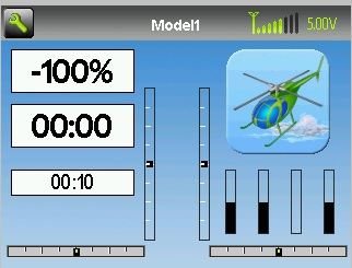

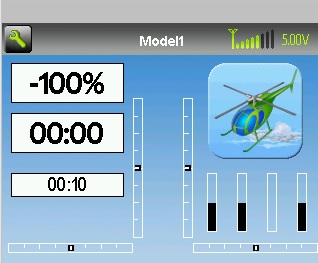

Hi all,
Long time ago I wanted to start helping with the development of deviation but until I got a 12S not found the time to do it.
Using deviation I always found the trim bars a bit annoying so I decided to modified them and improved them a bit.
The new bars that I made have: middle, quarter middle and eight marks.
Also the slider mark had been improved.
I attach here the code of the new _bargraph.c if Phractured wants to add it.
I would like to start helping with the development and improvement of the deviation gui with the permission of Phracture and all the other masters.
Hope that u like the change,
Cheers,
Lyndros

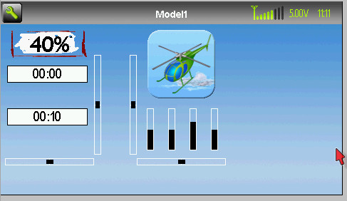

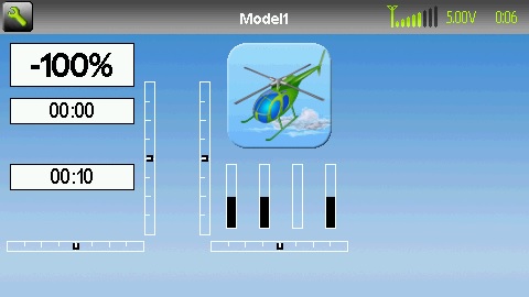

But is there a mistake with the size of the white line in the middle of the mark? It has a little gap to the right / lower edge of the mark, but not to the left / top. I would have expectedinstead ofThanks for improving deviation. Pushing it to bitbucket will help PhracturedBlue to integrate it.
// Marking rectangle
LCD_FillRect(xpos - TRIM_MARK / 2,
y + TRIM_MARGIN * 2, // #### * 2
TRIM_MARK, height - TRIM_MARGIN * 4, disp->outline_color);// Marking rectangle
y + TRIM_MARGIN,
TRIM_MARK, height - TRIM_MARGIN * 4, disp->outline_color);- Lyndros
- Posts: 57
02 Sep 2013 11:08 #13486
by Lyndros
Replied by Lyndros on topic IMPROVED TRIM BARS
It was intended I wanted to do the bars looking a bit like the futaba 18mz. (see bar.jpg)
Anyhow I modified the horizontal bar just to see both designs.
The one that you like most I will try to uploaded to the repo.

Ah, I see where your idea comes from. I don't know Futaba's gui but it looks quite good although the trim bars seem to be wider but shorter than they are in deviation.
But actually the slider and the value lines are both on the same edge of the trim bar. Futaba draws them at the opposite edge.
I would recommend to make some pictures of different realizations and ask the forum which is liked best.

I like the modified (second) exsample

Also I have finally finished the bars that I wanted to make at first instance, here you can have a running example of my current source code. (see the attached picture, horizontal trim bar).
On the other hand this type of boxes and depth things require much more colors, so we would have to find a proper place to define all the colors.

I think, if you want richer lookfor the bars, in the long run using bitmaps as background is the way to go.Lyndros wrote: On the other hand this type of boxes and depth things require much more colors, so we would have to find a proper place to define all the colors.
However that would make them fixed size, so then we should have quite a few bars with different sizes...
