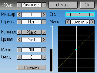

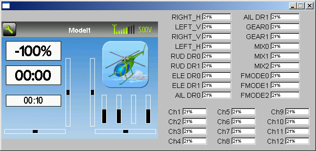

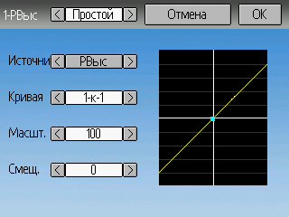

29 Nov 2013 04:02 - 29 Nov 2013 04:16 #16014
Replied by vlad_vy on topic publishing an intermediate release 3.1.0?
Last edit: 29 Nov 2013 04:16 by vlad_vy.
29 Nov 2013 04:14 #16015
29 Nov 2013 04:28 #16016
Replied by PhracturedBlue on topic publishing an intermediate release 3.1.0?
I had setup the emulator to use our internal sprintf implementation to get more thorough testing. But it doesn't support %f which is why you saw that.
I've fixed both the issues you mentioned.
29 Nov 2013 04:50 #16017
Thanks, now all looks fine!
