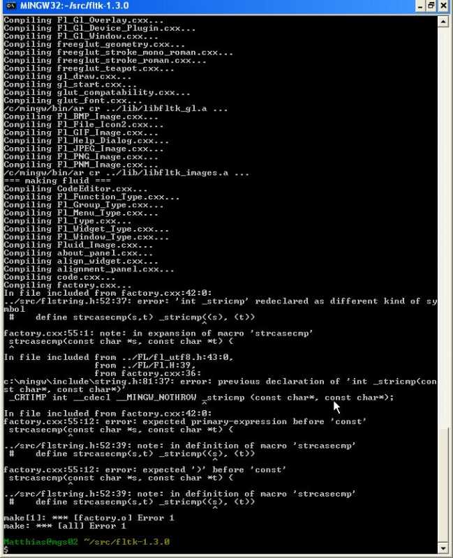

I tried to get my own environment. Unfortunately I was very long out of the business (Borland C under DOS programming framegrabbers and serial I/O
) . Now getting problems while using sh to compile fltk (1.3.2 and 1.3.0). Please see the Screenshot.
I only found two matches for _stricmp and tried to remove the match in fl_utf8.h without sucess. Must I set any complier switch or is any dev missing?
Thanks Matthias

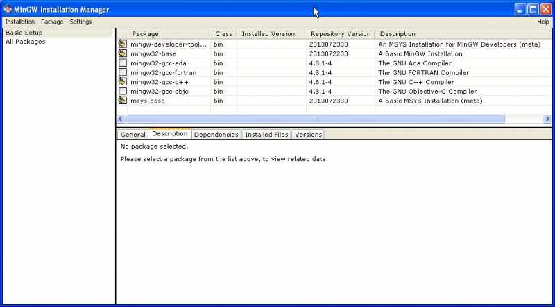

I will try to isolate the issue. Could anybody post a screenshoot of the latest mingw installation manager which option must be hooked.

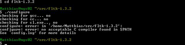

New install - mingw-get-setup does run two js files. JS files have not correctly assigned on this machine fixed now and installed as shown.
did the normal mkdir, tar etc. and configure with following result.
On my first attempts I added "/C/" to mingw/bin which enabled the gcc but RugWarriors environment is running without?!
I think I have to fix this issue first before doing makefiles. Can anybody help?

PATH: .
PATH: /usr/local/bin
PATH: /mingw/bin
PATH: /bin
PATH: /c/WINDOWS/system32
PATH: /c/WINDOWS
PATH: /c/WINDOWS/System32/WbemI think I have to fix this issue first before doing makefiles. Can anybody help?
