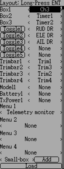

30 Dec 2013 18:07 #17491
by kreidler
Replied by kreidler on topic Swash discussion
Waldo could you please also update both attached images.
From the safety warning I removed the margin and to the layout screen the labels for power and battery have been added.

I am sorry but 5 minutes ago PB pushed a new commit (b11cfd7). Here is the updated screen.
30 Dec 2013 18:22 #17493
Replied by PhracturedBlue on topic Swash discussion
You duplicated some of the icons twice. I've already pushed updated docs with the proper image changes. Thanks.

- kreidler
- Posts: 157
31 Dec 2013 13:36 #17565
by kreidler
Replied by kreidler on topic Documentation Discussion
Last pass for the 7e/10 manual from my side as pull request.
EDIT: Just realised that the toggles are now standard. Therefore I attached the actual main page config. Please replace the old one.
This was the first time that I had a deeper look into the color manual. As you know only owning a Devo10. I think the next time I will edit the curves with the color emu and afterwards copy to the 10. I do not want to alter the manual with my small remarks. Therefore please find my two cents below:
