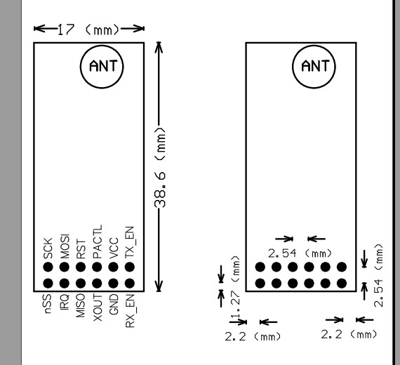

Yeah those details are not for here but this might be useful. They didn't come with the board when I ordered it. The 3rd party agent I used was kind enough to ask them for it after the transaction.

I just got my batch of these modules today. These are basically perfect for the universal module. The only downside to them is that they use the larger SMA Antenna rather than a U.FL which would be more convenient. But they are small, cheap and fully expose all CYRF6936 and PA connectivity (except for Bypass I think)
I don't have any room on my universal board to mount it though. I'll probably design an alternate using this module instead.

Hi, sorry for reviving this old thread for something unrelated to Deviation ...
I want to make a DSM2/DSMX transmitter module for a Taranis X9D from a CYRF6936, I got something working with a CYRF6936 module harvested from an old WK2402 radio:
... but this module has no PA+LNA, so I just ordered the module from buychina after reading this thread ( www.buychina.com/items/2-4g-module-cyrf6...m-module-uuruunslkhi ) and I've a few questions :
The module has 3 pins for power control (I suppose), RX_EN, TX_EN and PACTL.
I suppose RX_EN and TX_EN are the same things as on A7105-D03 modules, i.e TX_EN has to be connected to Vcc (+3.3V) when transmitting, or RX_EN when receiving (my goal is to convert Spektrum telemetry data to FrSky smartport), but I have no idea what the PACTL pin is for, pardon my ignorance
Can someone explain please ?

Replied by goebish on topic Finding a source for CYRF6936 transceivers
I guess it means Power Amplifier ConTroLler, but I don't know how I should manage this pin.

Try this data sheet (AWA24S module) and this website
sites.google.com/site/mrdunk/interfacing...avr-microcontrollers
Hope it helps!

Ok thanks, so from what I understand, PA_CTL should be driven HIGH when transmitting, and LOW when receiving (just as the TX_EN pin).
I see the voltage should be 0.3-3.3V in TX mode, I suppose this controls the power amplification factor, well, I'll be fine with 3.3V

Yes, that's the way I understood it also. The data sheet suggests that you can tie TX together with PACTL, but watch your current (Page 7, item 8, RF Power Amplifier). Let us know how it goes. Goodluck!
