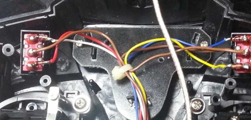

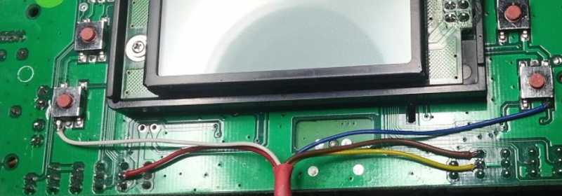

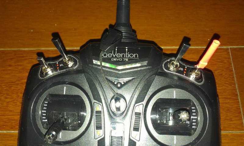

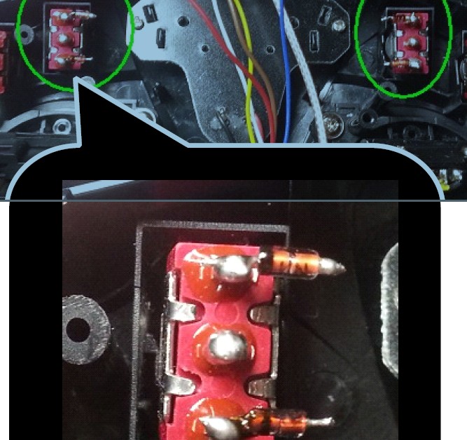

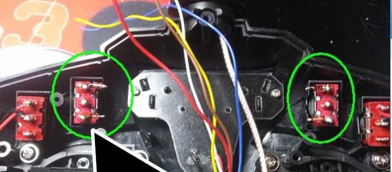

- dianjing
- Posts: 24
02 Jan 2014 21:52 #17780
by dianjing
Replied by dianjing on topic devo 7e deviation 4.0.0 - 2 switch patch problem
- dianjing
- Posts: 24
02 Jan 2014 21:53 #17781
by dianjing
can you help me again. to send me the new firmware for 2*3sw .
thank you !!
thank you !!
