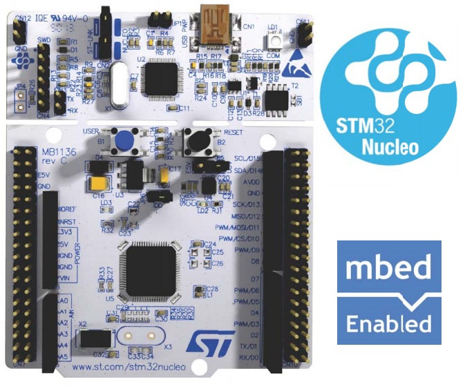

Size is good and simple solder, connected! 3.3>6 volts
Splitting pcb up would fit with my ideas! Still as it is really want one for my FG12.
Also size could stay the same but deeper and 4 layer RF would be smaller (cheaper) and rest could be 2 Layer pcb. Maybe even Arduino style shield!.....
£8.00 so cheap and extra pins
Once STLink is removed Board is 64x64mm and have StLink .
So all in yeah I'm up for it....what next ?

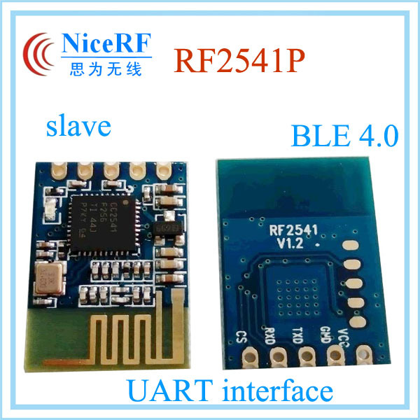

www.aliexpress.com/item/2pcs-RF2541P-blu...541/32214896680.html
Links a little confusing. Say's 2 but price is for 4 piece Lot @ $16.20 US $4.05 / piece
