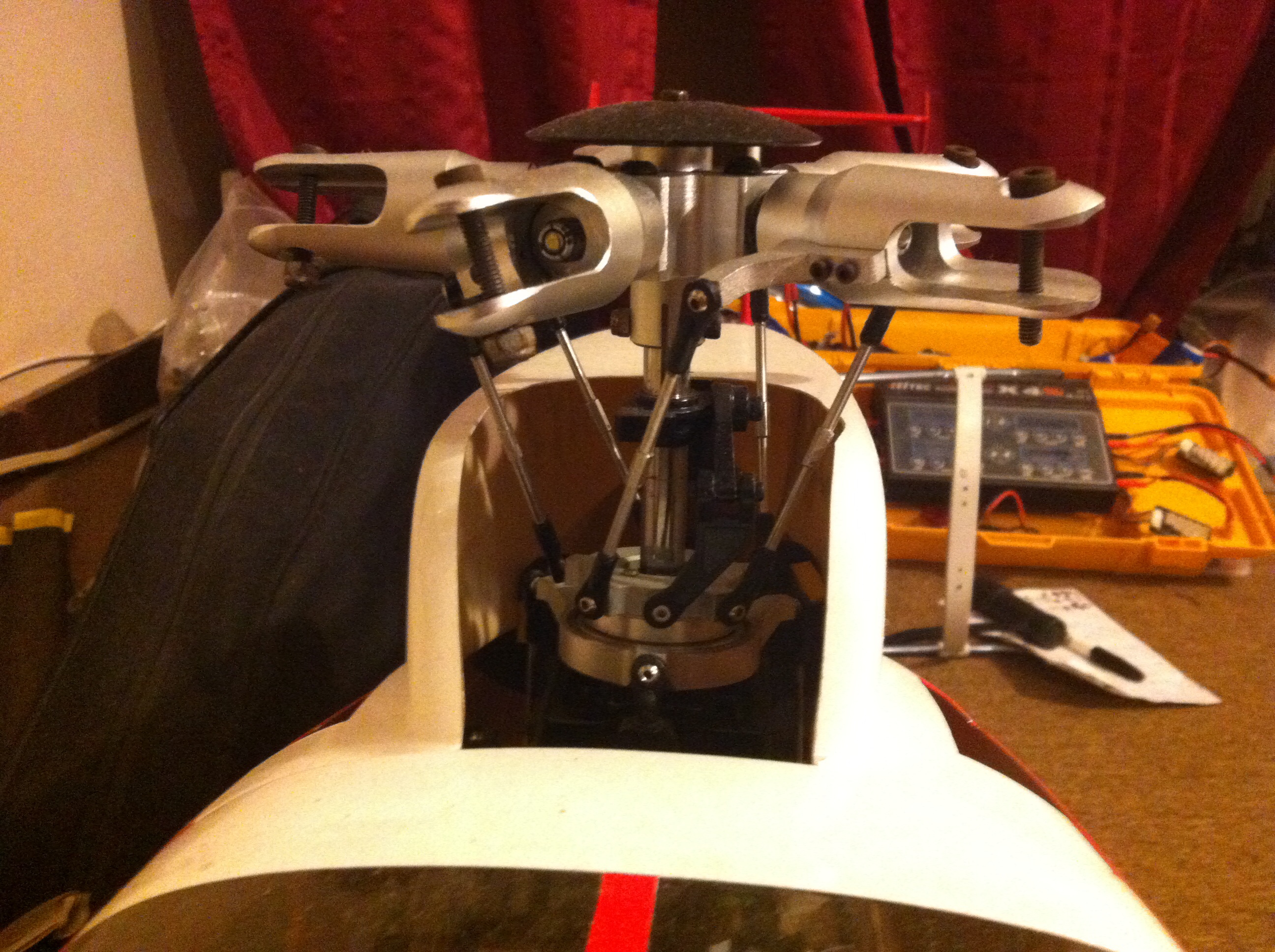

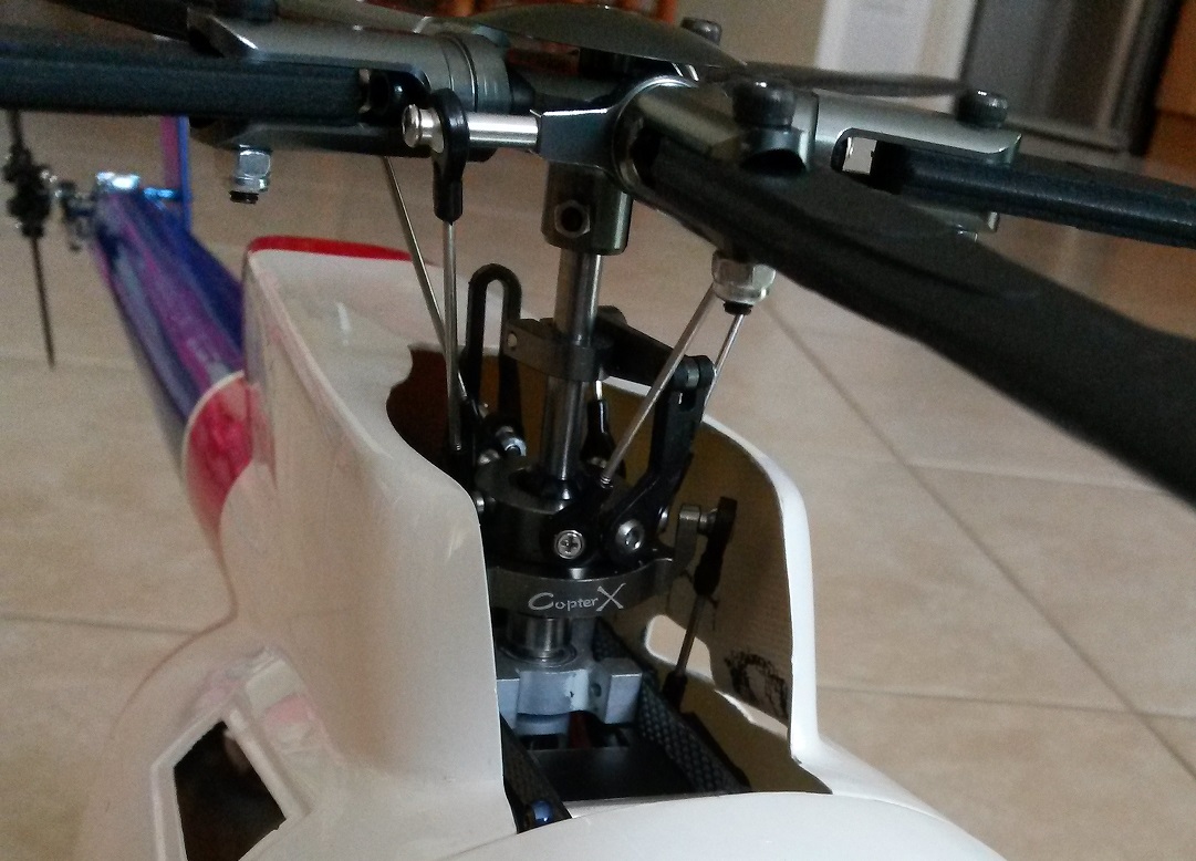

So you may notice: the control rods on the head are not parallel to the main shaft - to properly set the mechanical 90 deg. phase advance (= the attachment point of the control rod on the swash is 90 deg forward to the blade)
That looks awful
...and keeps the main shaft unnecessary long. Parallel rods could be much shorter, head could go lower, bird would be more scale and nicer
That looks awful

"... but having the links on an angle, to get the phasing correct, will allow you to lower your head."
You are right. My words were short... I meant if I could use parallel rods, I could replace the rods with shorter ones (almost zero visible metal lenght)
AND replace the shaft with a shorter one, for example with a DFC shaft.
(If I'd shorten the shaft now, the follower would hit the rods)

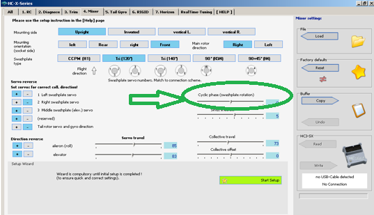

The answer is: V-bar. I have 3 of them installed in other helis...
Just need to tear the 3GX out and swap it with any of my Vbars...
I deserve a facepalm.

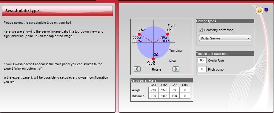

This is the screen I was overlooking for almost a year. Technically, I can set the phasing with the "Rotate" button into any degree...
