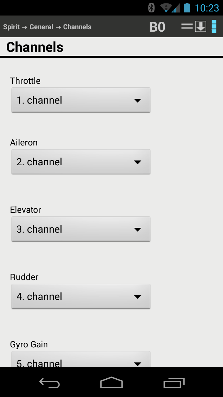

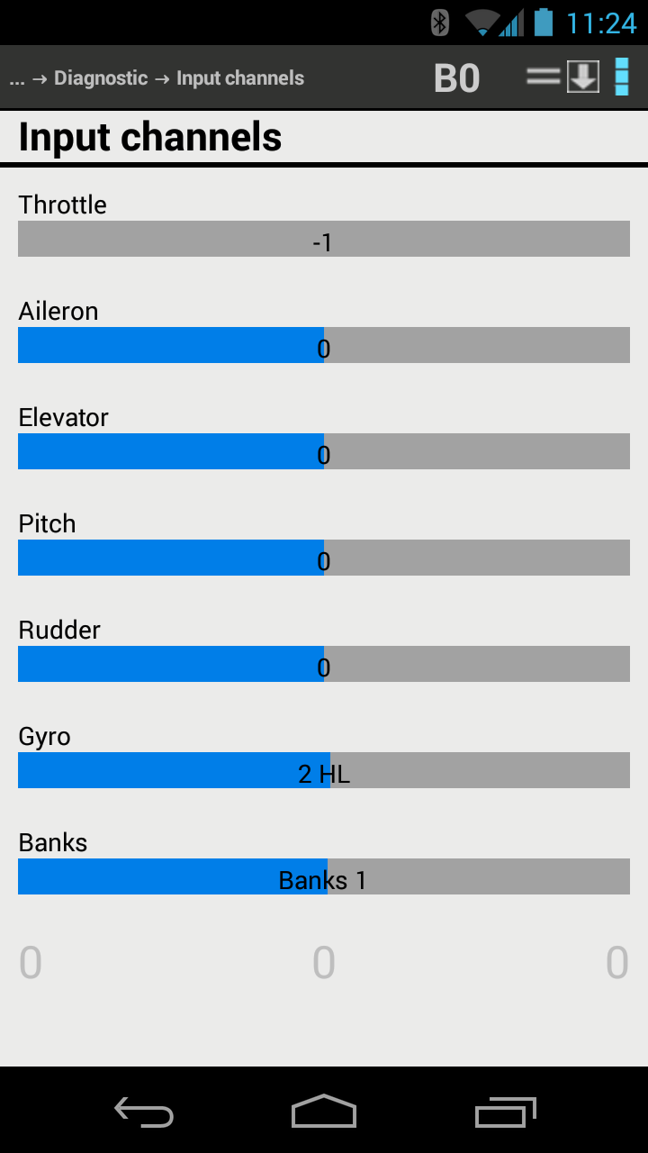

PhracturedBlue wrote: It seems like at a minimum I need a test page to show current channel values, or else it will be difficult to figue out how to map the PPM channels to the protocol channels.
Hi PB,
I would like something like the Deviation "channel-Monitor" to show the actual protocol output.
With tapping on one of the channel-bars there should pop up some sort of selection menu for the corresponding input channels.
Here another example how Spirit-FBL App does similar task:
Last edit: 01 Apr 2015 09:29 by linux-user. Reason: added 2. screenshot
