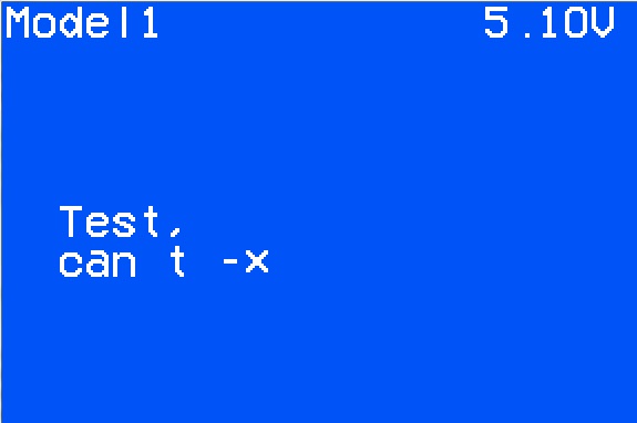

27 Apr 2015 15:36 #31700
Replied by PhracturedBlue on topic Can Any help me with my F7
Trying to figure out how to map the various controls for the F7 display.
Here is what I've got:
Button/Selectable list item:
Text-select widget (no button):
Text-select widget (with button):
There is a 'blink' attribute that we can use for alarms I think. The F7 display does not support changing text color or background color (except globally) so we're pretty limited in what we can do

I'm still learning how the screen is working on deviation. I'm working too slow. if you can say me the function for write a character on some position. Now I'm using this:
GUI_CreateLabelBox(&gui->bat, LCD_WIDTH - 7,0, 0, 0, &DEFAULT_FONT, voltage_cb, NULL, NULL);
I'm trying to do a trim bar,for now I only have the battery message.
Last edit: 28 Apr 2015 03:36 by djtrance.

28 Apr 2015 03:44 #31727
You need this:
LCD_PrintCharXY(uint x, uint y, char c)
Note that this is a low-level command and should only be used within GUI_* objects. Specifically the 'bargraph' widget in this case.
