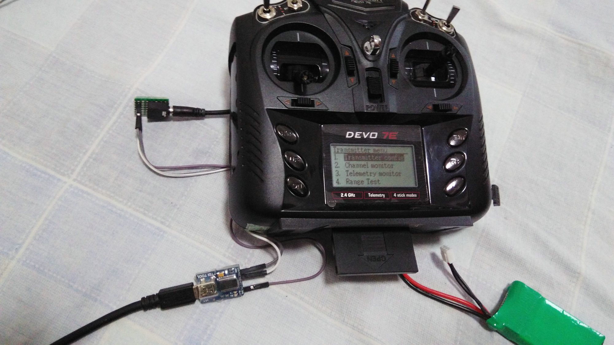

So I modified lines in syscalls.c as below:
#define dbgprintf(args...) printf(args)
//#define dbgprintf(args...)
then make as "TYPE=dev", update my Tx using the new build dfu file.But I cannot get the log.
I attach the photo for the connection of trainer port and usb-ttl
03 Jul 2015 11:55 #35052
Replied by PhracturedBlue on topic How do I get debug log from the trainer port?
did you do a 'make clean' 1st?
you do not need to enable dbgprintf unless you want a LOT of logging. The default wil still print a bunch of intialization when you power it up
Are you running the latest deviation? if not you need to run 'make distclean' 1st (latest deviation from source should recompile everything when you change the value of TYPE)
When in doubt reverse the rx and tx lines. I assume your usb-uart is 3.3V compliant? This should be very easy to make work. I've never used an ftdi, but I see no reason why it would be different than the CP2102 I use

03 Jul 2015 14:52 #35056
by payne.pan
Replied by payne.pan on topic How do I get debug log from the trainer port?
Ya, I found the problem is in the connector I made, some pins on the audio slot is just for fixing, I re-soldered them and make sure it is right. Now I get the log!
Thank you very much for information and analysis.
