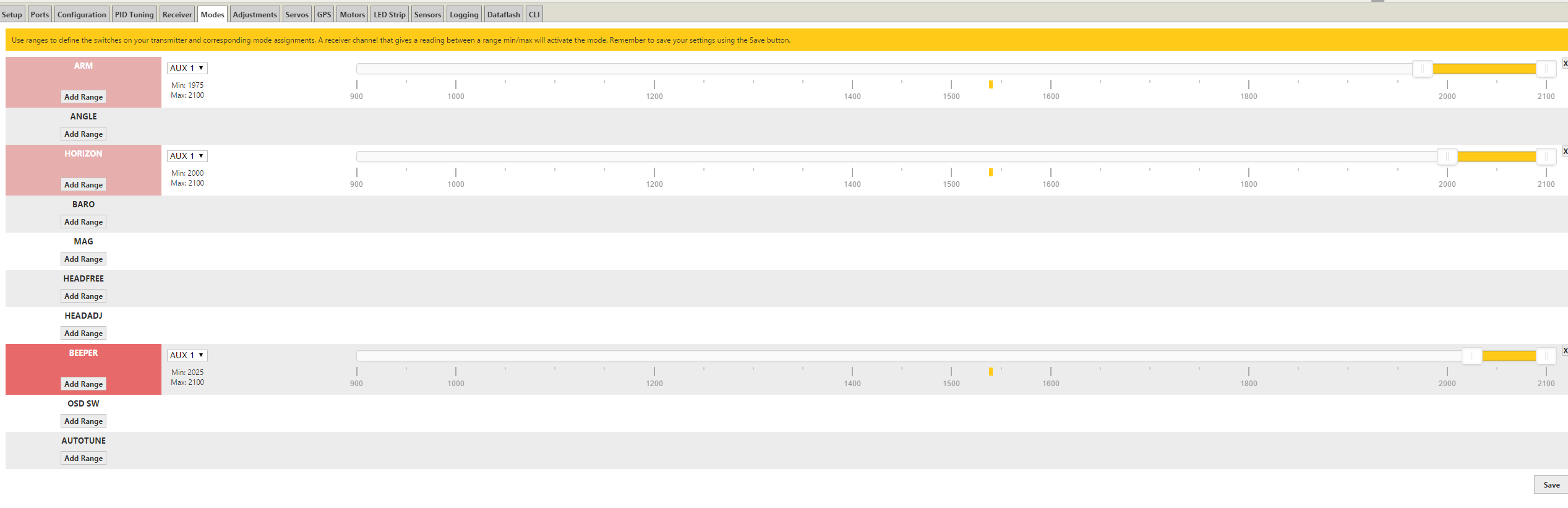

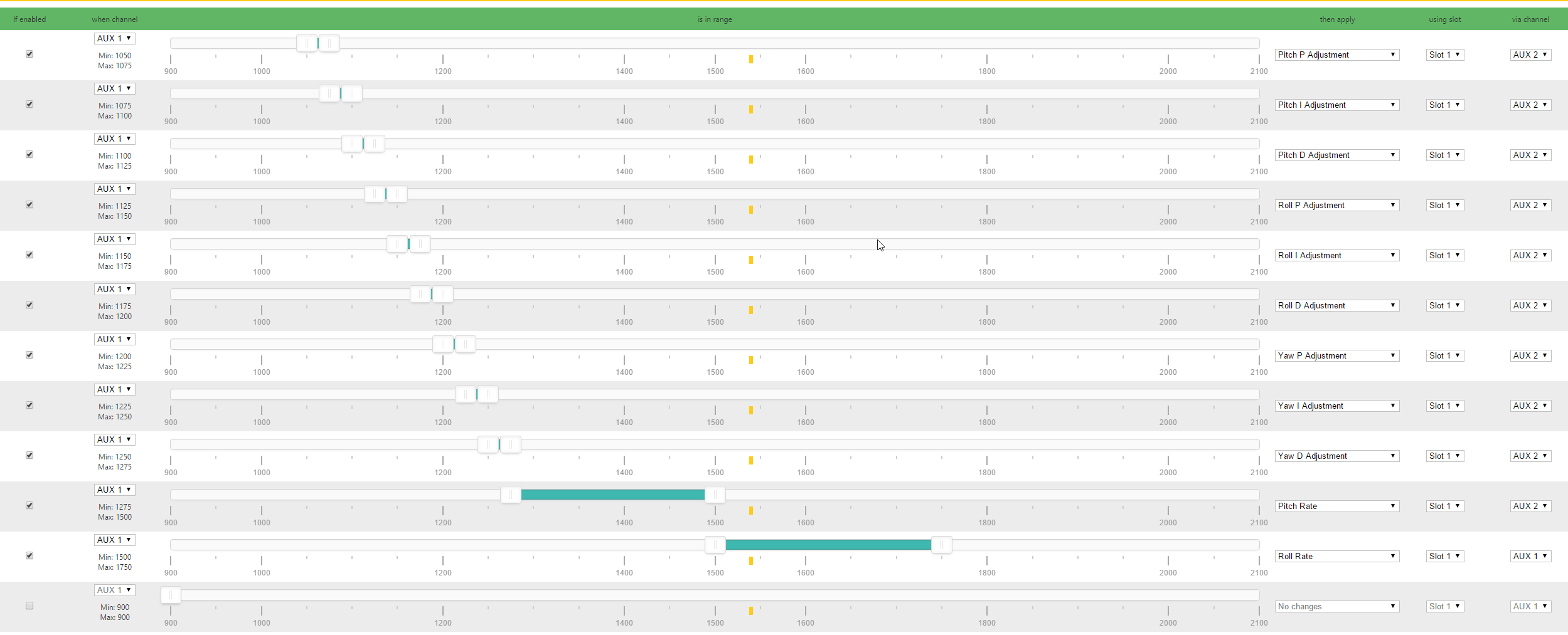

25 Jul 2015 17:58 - 25 Jul 2015 18:03 #35967
by Rand__
Replied by Rand__ on topic More pages/mixers in Custom mixer
I can show you what I am doing;)
I split up one channel into 10+ different distinct values and each specific value is assigned an adjustment or mode selection in CF.
Each adjustment gets a minimum slice (room for improvement on CF;)) so i can set up many different adjustments (eg using 3 3way switches) using just one channel.
Additionally I handle ARM and mode selection - buzzer didnt have a free mixer in deviation to use;)
I've set this up as complex mixer on ch5.
It looks like using several virtual channels would enable me to user more then 10 mixers - that probably will do the trick, gotta give it a try - thanks:)

25 Jul 2015 20:25 #35974
Replied by mwm on topic More pages/mixers in Custom mixer
Ok, so what's happened is that you're using the extra flexibility of deviation to get more control of cleanflight directly than I think they pictured anyone doing. Given that tuning the thing should be relatively rare, I'd be tempted to use one of the two extra trim switches to cycle through those values on channel five, and put channel fives value in a display box. I figure remembering those values should be about as painful as remembering switch setting, and this is a much less complicated setup.
The virtual channels trick will help. In fact, putting all this in one virtual channel, and having a switch to use it on channel 5, and otherwise you use the switches to get between flight modes for normal flight instead of tuning might make things less error prone no matter how you select a tuning mode.
There's also a technique you can use to get 3 values from a 3-way switch with two mixers. The first mixer uses a fixed curve type with one of the switches enabling it, just like you are doing now. The second mixer is enabled by inverting the switch used to enable the previous mixer, the curve type is min/max, and the source is one of the two switches not being used. You'll need to adjust the scale & offset to get the two values you want in that case.
With that, you can use one channel and have different values for all possible states for the five 3-way switches I think the Devo 12 has.
