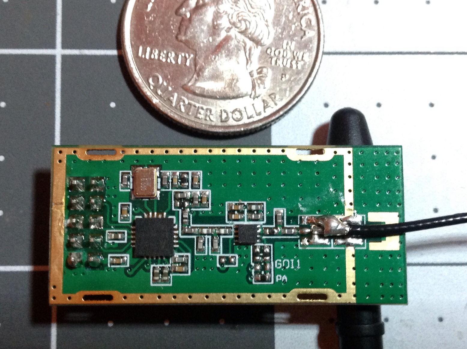

I could use a bit of help with this, though. I've already got the data pins and ground from reverse engineering the Joysway protocol. But can anyone tell if this has a PA or similar on it?
Here's a (bit blurry) shot of the top of the A7105 and pins used to reverse engineer the protocol: deviationtx.com/media/kunena/attachments/546/IMAG0181.jpg
And here's the back of the module from the same thread:
deviationtx.com/media/kunena/attachments/546/IMAG0184.jpg
If not, then I just need the five standard A7105 connections, right? If it has a PA, do I need jumpers on some of those pins, and if so where?
And while you're looking, can someone point out which pin gets 3.3Volts? I can probably find it myself, but figure it'll be faster for someone who knows what they're doing.

From your blurry picture I'm pretty sure the IC marked "1110" and a lot code refers to a +23 dBm PA IC "AP1110". Also not the "PA" printed on the PCB close to it.

Moeder wrote: From your blurry picture I'm pretty sure the IC marked "1110" and a lot code refers to a +23 dBm PA IC "AP1110". Also not the "PA" printed on the PCB close to it.
That would make it a really good module to harvest.

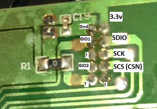

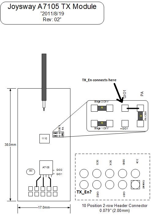

I examined the Joysway A7105 (thanks, MWM!) and I was able to determine the GIO1 and GIO2 interface pins in addition to the SPI, power and ground. I wanted to determine the correct signal lines before i actually connect it up to my transmitter. I've attached a quick drawing of what I have found so far.
The GIO1 line appears to terminate at a jumper pad in the box in the upper right corner. It has a label GOI1 and PA, but the pads at GOI1 are not jumped. The side not connected goes into the PA voltage control circuits as described in the AP1110 documents . It appears to me that there is a circuit to control the PA.
The GIO1 and GIO2 pins are exposed at the 10-pin connector, along with SCS, SCK and SDIO and of course 3.3v and ground. There are three additional pins I cannot identify, marked with a "?" on this close-up. Does it make sense that they may include TX En or RX En? If they were those pins, where would they connect on the A7105 or support circuits? I ask because I don't want to pull the cover off my XL7105-D03 to see if I can match up traces.
My next step is to connect it to my transmitter and logic analyzer. I'll post my findings!
Last edit: 25 Mar 2016 23:10 by Deal57. Reason: Updated Drawing

After staring at the board long enough I also figured out what I think is TX_enable. On my drawing it's the bottom row lower left corner next to GIO2.
This pin would connect to the lower left corner position on the main board, and there is a lead on the main board (can't tell what it does; there's a resistor there). The pin connects to the un-jumped GIO1 pin in the jumper pad that attaches to the PA. IIUC, (on the XL7105D03) when GIO1 goes ON it energizes the PA for transmit, then when GIO1 goes OFF, GIO2 goes on and sets up for receive. If I'm getting this right, the transmitter MCU has control over GIO1 and TX_En like it works in the nighlies.
If that's the case, then i need to find RX_enable, and it's one of two pins. Is there a chance you could get a close up of the other side of the main transmitter board in the area of that 10-pin connector?
Can someone tell me if the process would work with just enabling/disabling GIO1?

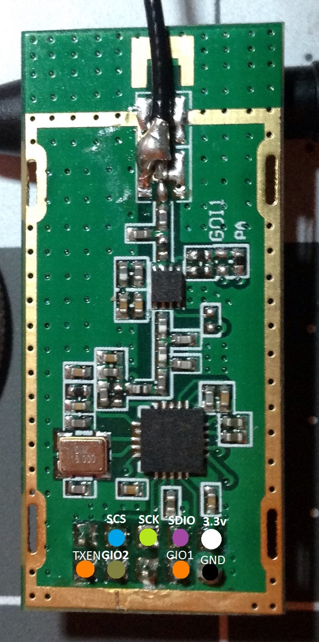

@mwm... sorry this took so long, but I'm glad to say the Joysway A7105 TX module is working great. I finally wired it into a Multimodule using the XL7105 header. I plugged the MM into my Devo6s and it bound to my ProtoX right away (uses Hubsan protocol). I flew the ProtoX around a bit, tried a few controls, turn on/off lights, and watched the battery voltage telemetry as the power dropped to LVC.
The cabling is pretty straightforward and matches up to my drawing from a few posts back. I still don't know if there is a pin for RX_EN, however power settings and telemetry are functional.

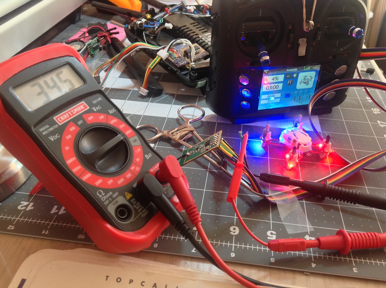

I measured the 3.3v power and got somewhat useful results on my cheap multimeter. It's pretty clear the TX power is responding to the model settings. At 100uw the board consumes about 24ma, at 30mw, between 32.5-35.5ma, at 100mw 36-37ma. I tried 150mw several times, and got varying results, a high of 38.5ma, a low of 36.7ma. The Hubsan was bound in all of these measurements with very low rpm on the motors. When I select a different protocol using the CYRF module, the power reads 25ma.
The range test worked well... I walked about 30ft in the house into another room and signal appeared to be stable, and telemetry showed the battery voltage correctly. During my power tests on the bench however, telemetry occasionally dropped out, so I'll have to keep track of it as I actually fly the little thing.
Now that it is installed, I will connect it to the logic analyzer and get a few captures.

I've edited this photo of the Joysway A7105 TX module to match the color coding in the WIKI. I can post it there if desired.
