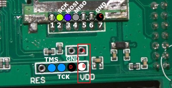

Hi, I just started with this hobby, and decided to order 3in1 module for my Devo 7E.
I've gone thru all information regarding installation of this 3in1 module, and found out some picture posted by others (Leo Li and dc59)
I would like to ask a few questions on Devo 7E pinout:
1. Which are the VDD pin, A or B or both? Is there any difference if 3in1 VDD soldered into pin A or B above? Leo Li use pin B, while dc59 use pin A.
2. Is there any difference if GND soldered to pin C or pin D? I read some information that someone experience frozen Devo 7E when he soldered A7105 to pin D, but then problem solved when he re-soldered GND to pin C.
Thanks in advance.
Thanks in advance.
