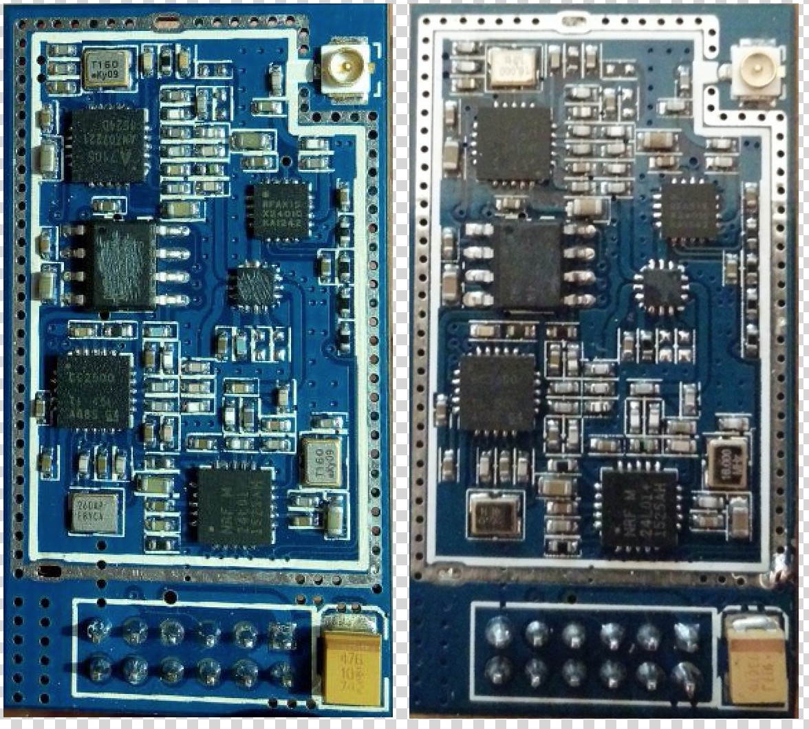

kahuna001 wrote:
Left original Rev and Right Current.
The small 12pin chip looks like 2.4GHZ CMOS SP3T ANTENNA SWITCH RFX333 ( www.skyworksinc.com/uploads/rfx/RFX333_DataSheet.pdf )
The big 8pin chip must be a MCU, maybe one of those ATTiny chips
Don"t know why their markings needed to be removed....
Last edit: 23 May 2016 08:03 by valley_nomad.

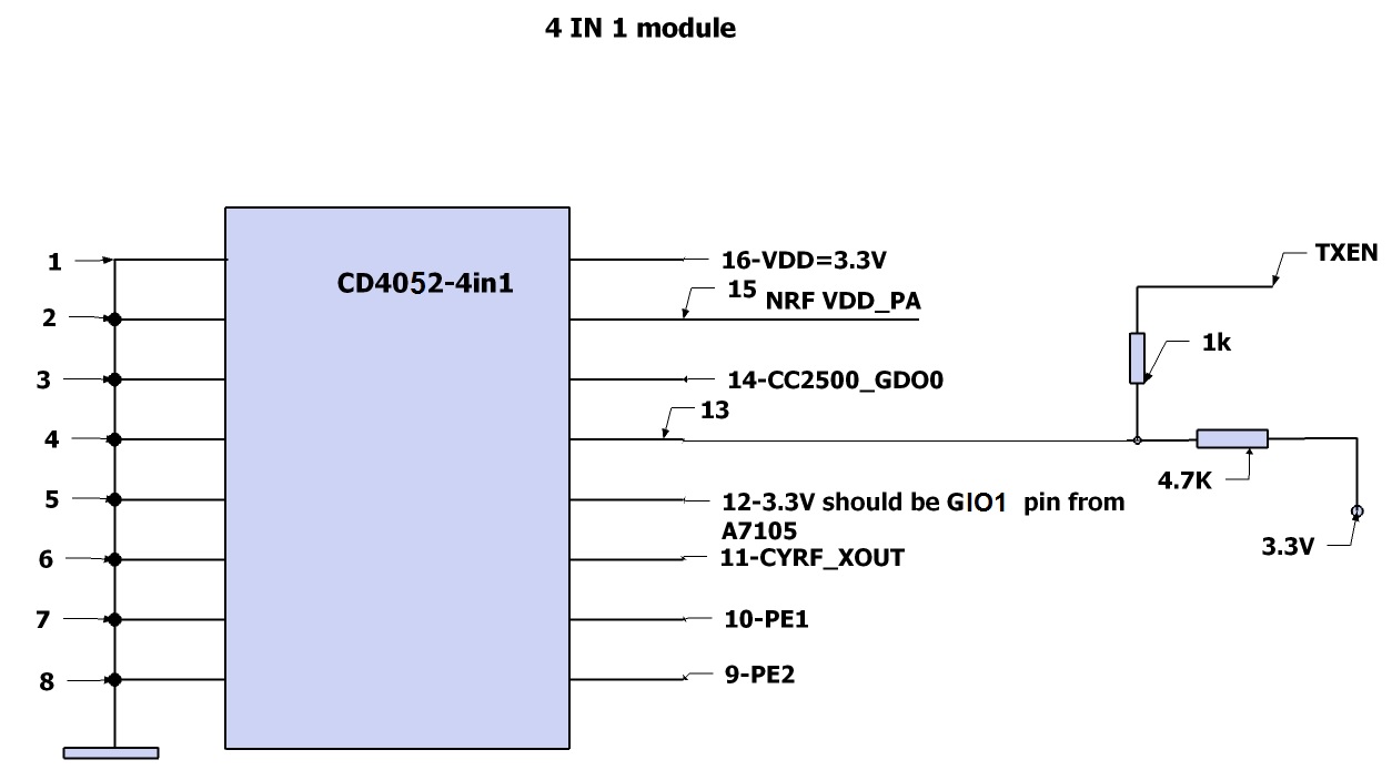

The chip maybe like 4in 1 is similar CD4052 multiplexer.
The control can be via PA /LNA pins and CD4052.

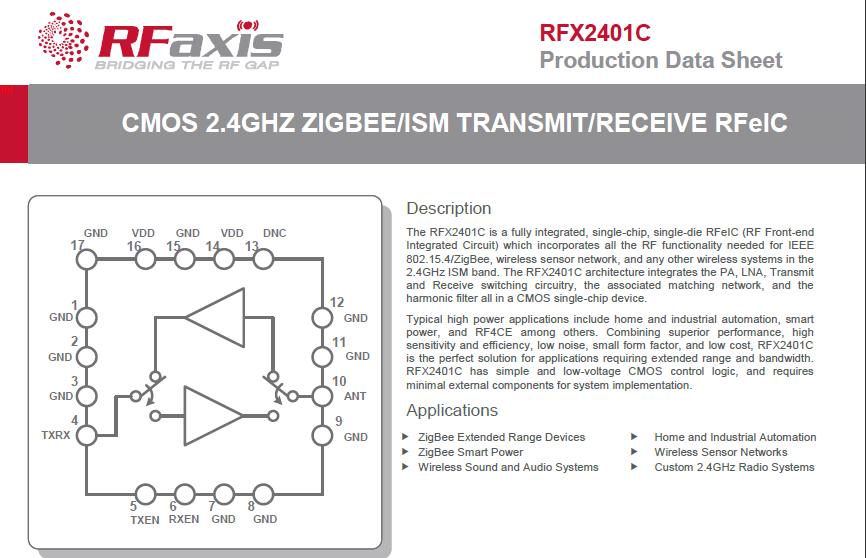

It may be more than a matter of not having a LNA. The "PA" chip, say RFX2401C, has both PA/LNA. It is sitting in between the RF chips and the antenna. Unless the board has a way to bypass the "PA" chip and connect the RF chips to the antenna on receiving, the reception could be way worse than just not having a LNA especially if the RF chips are sitting inside a metal shield.
Besides enabling PA or LNA, the chip can be powered down. However the insertion loss between TXRX and ANT would be something like 50dB, not really passing through...
Regarding the devo code not providing control, it does control PA/LNA switching on standalone RF modules using outputs from the RF chips, on A7105 through setting GIOPIN1 and 2 (see A7105_SetTxRxMode), on CC2500 through setting IOCFG0 and IOCFG2 (see CC2500_SetTxRxMode) and on NRF24L01 by setting TX mode which changes VDD_PA (see NRF24L01_SetTxRxMode). As I said before either the MCU onboard has to listen in the spi or it has to monitor those IO/VDD_PA pins to know about mode changes. It probably is too complicated for hardware multiplexer to decode them directly. Perhaps it is time for the N in 1 board suppliers to tell the deviationtx developers what the boards need to work correctly. It looks like extra control pins are already there on board, we just need to know how to make use of them.
BTW, CD4052 probably won't work too well for switching 2.4GHz.

wasp09 wrote: ... It may be more than a matter of not having a LNA. The "PA" chip, say RFX2401C, has both PA/LNA. It is sitting in between the RF chips and the antenna. Unless the board has a way to bypass the "PA" chip and connect the RF chips to the antenna on receiving, the reception could be way worse than just not having a LNA especially if the RF chips are sitting inside a metal shield.
Regarding the devo code not providing control, it does control PA/LNA switching on standalone RF modules using outputs from the RF chips, on A7105 through setting GIOPIN1 and 2 (see A7105_SetTxRxMode), on CC2500 through setting IOCFG0 and IOCFG2 (see CC2500_SetTxRxMode) and on NRF24L01 by setting TX mode which changes VDD_PA (see NRF24L01_SetTxRxMode). .....

Additionally according to RF path in RFX2401C the statement on 3-in-1 module's capability of receiving telemetry data with limited distance may also be false

24 May 2016 21:44 - 24 May 2016 21:45 #49145 by midelic
Replied by midelic on topic 3in1 / 4in1 RF module
CD4052 on 4in1 module and is not used for switching 2.4Ghz.It is connected with PA/LNA chip TXEN pin and PE1 PE1 Peregrine antenna swicth pins.
If you check data sheet of CD4052 you'll understand how it is working
Last edit: 24 May 2016 21:45 by midelic.

24 May 2016 22:11 - 24 May 2016 22:12 #49148 by midelic
Yes I'm preparing for a fix on A7105 and NRF 24L01 LNA.
I need to remove the pullup 4.7K resistor on TXEN pin cut 3.3V trace corresponding to A7105 and bridge togheter CD4052, pin12 with pin 11,and modify code for using CYRF XOUT switching A7105 to LNA.
Last edit: 24 May 2016 22:12 by midelic.
