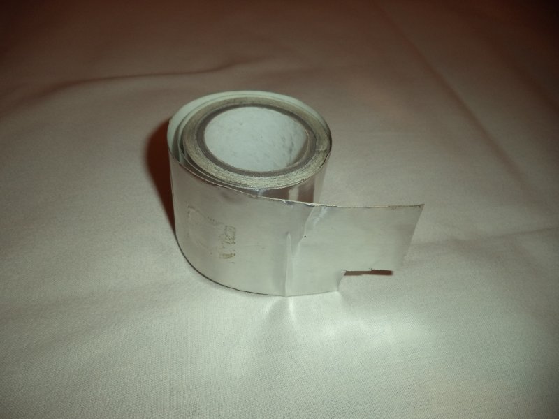

13 Jul 2016 06:50 #51597 by dado099
Replied by dado099 on topic 3in1 / 4in1 RF module
Useful tip:
If you have to solder on the MCU the third selection line and you don't find kapton tape,
you can use instead simple aluminum adhesive tape found in most hobby stores.
