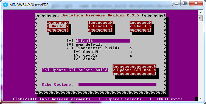

Would someone with a Mac be willing to try to use the latest docker image, mounting a pre-checked out git repo from outside the image?
Assuming that works, I think I'm willing to say this is the official way to build Deviation going forward.

Connection was really slow for some reason and it took me over 2 hours to complete the pull.
Tested all builds (except x9d related ones) on OS X 10.10.5 against my forked git repository. Everything even the emulators work great. Nothing (not even permissions or owners) needed changing and worked on the first pass.
Great stuff PB! Thanks so much for this!
On a side note: it doesn't go back to the gui after building. This is intended, right?

Yes that is intended.
Thanks everyone for your help validating this. I'll start working on a proper cheatsheet documenting this process
