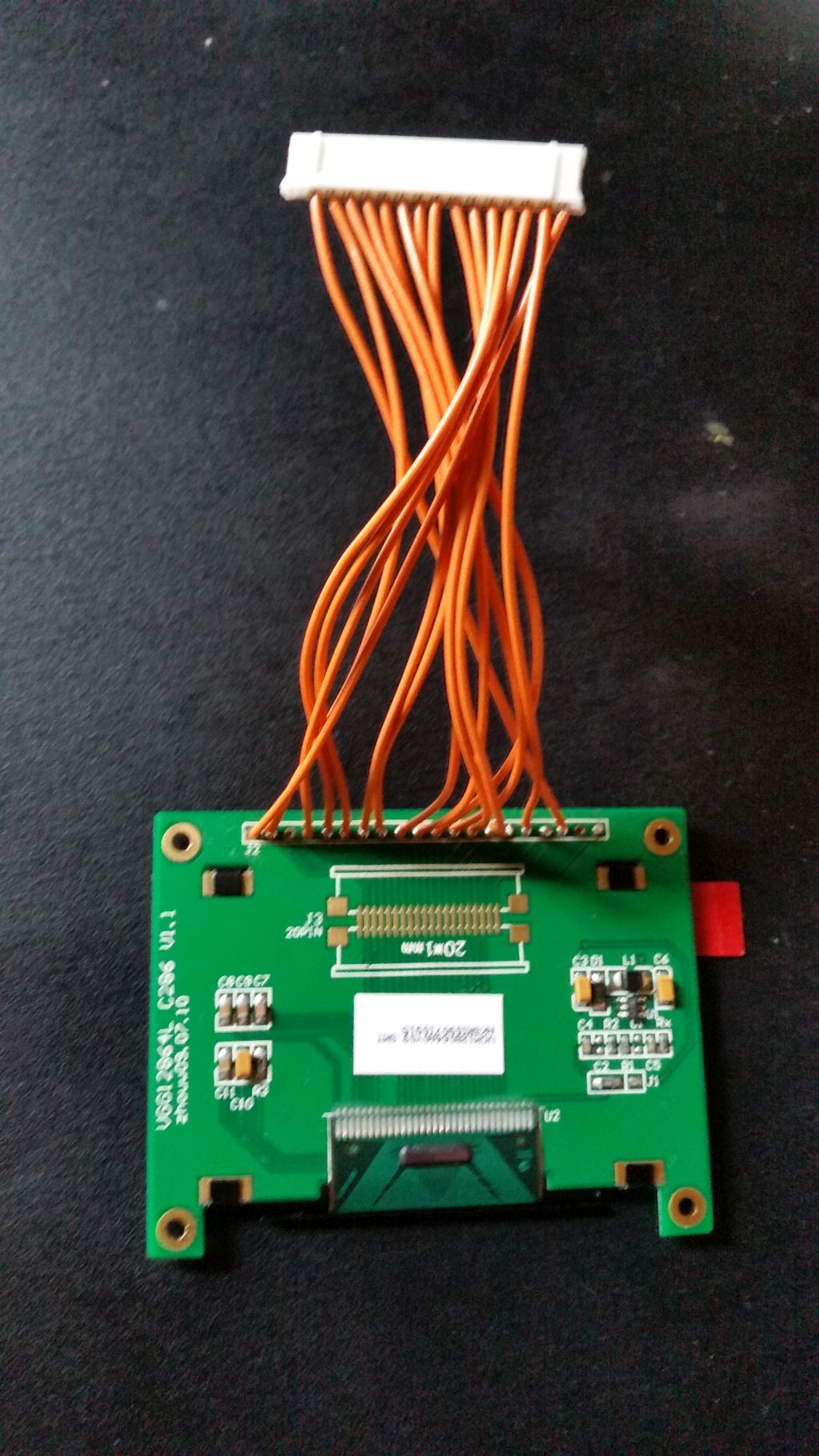

My Devo 10 screen has a column out so this got me looking around. Ordered this one to try. It's close in size to the stock module. The SSD1305 seems very similar to the 1309 so hopefully not much work :)
Anyone know the connector on the far end of the display module wire harness (the part that plugs in under the USB)?

I think the connector to mate with the Devo 10 is JST PHR-16. Should have everything in a week.

12 Jun 2016 21:39 #50486 by hexfet
Replied by hexfet on topic Replace screen
No joy just plugging it in with no changes. Likely not plug'n'play, or I got some wiring wrong, or the module's bad :) But just got some work so won't have much time to spend on this for a couple weeks.

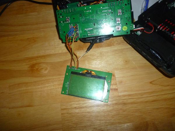

11 Jul 2016 08:42 - 11 Jul 2016 09:16 #51544 by john
Replied by john on topic Replace screen
today , i try to connect devo 7e with big LCD ST7565 , but failure . :lol:
that is Lcd I use for Project digital Clock , price cheap 1$
next , i will try with Oled 1.3 :woohoo:

11 Jul 2016 12:00 #51547 by SadSack
Replied by SadSack on topic Replace screen
Stock walkera firmware worked fine with modified I2c OLED screen. Mod screen to serial which was fiddly but go steady easy enough. I used the screen ribbon to make hardware changes to convert I2c>serial.
LCD I used was compatible with NT7 driver. Last line should have been the first line. Screen broke before I found out why. I had used screen with arduino using same initialising code as deviation worked and looked great. There is a pcb layout I'd done on bitbucket.org/SadSack/lcd-multi-spi-flash
All details where to get screen from.
