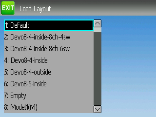

Another bug in current nightlies for main page configuration is, that on color touch screens (and emulators) nothing happens when pressing the load template button. Couldn't make out the reason yet unfortunately, but I have to admit I'm not that firm in the color GUI code...
07 Mar 2017 12:46 - 07 Mar 2017 12:47 #59948
Replied by vlad_vy on topic Main page config hangs/reboots
Load/Save layout page work normally, I tested it by changing call at other page. So, button call at layout config dialog do nothing.

Indeed, I tried the DEVO 8 emulator, and the template load doesn't work, but writes this onto the output:
ERROR: Page stack limit(6) exceeded- FDR

We need to move both version (modified and unmodified) "add_dlgbut_cb()" to 320x240x16 main_layout.c and 128x64x1 main_config.c, and remove from common\_main_config.c
I will place pull request.
