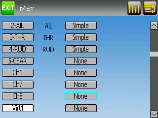

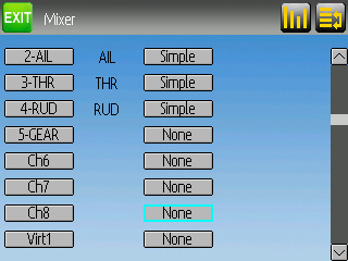

Hi everyone!
With the latest nightly build for the Devo 12S I have to following issue (did not check on previous firmwares):
When renaming a mixer, e.g. "Virt1" to any other name and also back to "Virt1" after entering the letters by the touchscreen the buttons "Ext, Ent, Up, Dn, R, L" are no longer recognized for inputs to the menu, only the touchscreen is available for inputs.
However the buttons are recognized correct in the "Button monitor" in "Transmitter menu".
The functionality comes back when I powercycle the transmitter.
If the buttons are used for changing the name of the mixer, they keep working as normal.
When using the touchscreen for mixer name inputs, the first input causes a "refresh" of the screen, the letter which should be input has to be pressed again to be entered in the name field. The further touch inputs are as expected.
Just for information: When using the touch inputs for a model name this does not happen, the buttons work fine after touch inputs are made.
Am I missing something to "switch back to button input" or is this a bug in the firmware?
Best regards
Max

04 Apr 2017 18:10 - 04 Apr 2017 18:12 #61163
Replied by vlad_vy on topic Devo 12S no button inputs after renaming mixer
Last edit: 04 Apr 2017 18:12 by vlad_vy.
04 Apr 2017 18:25 #61165
Replied by FDR on topic Devo 12S no button inputs after renaming mixer
Does it work the same in the emulator, or only in the TX?
04 Apr 2017 18:29 #61166
I use emulator, since my real Tx use v5.0.0
04 Apr 2017 18:40 #61168
I see, I should have known from the screenshot...
