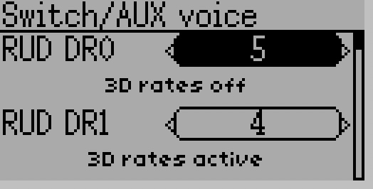

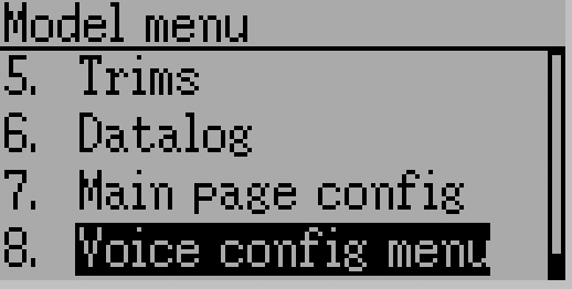

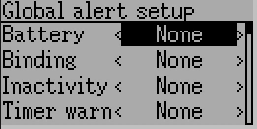

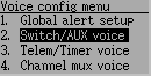

Hello voice fans,
I put a little work into improving the voice feature. I've split the voice config menu into sub menus as depicted below to allow for easier access to the desired settings especially on the monochrome screens. I also plan on adding a "global alert config" menu to allow choosing a model specific type of alert (buzzer, voice, voice + vibrate) for battery, binding, inactivity timer and telemetry alerts. I will also try to improve the output of AUX value output and suppress SW1 voice output when rapidly flipping from SW0 to SW2. What else is on your personal wishlist? Attached some pictures.
edit:why can't I add any pictures or files to my posts? now it does

For telemetry and timers you already can, so global alert setup the way I thought of it is just for selecting whether you want voice, voice + vibration or buzzer on select alerts (it doesn't make sense for switches IMHO).
