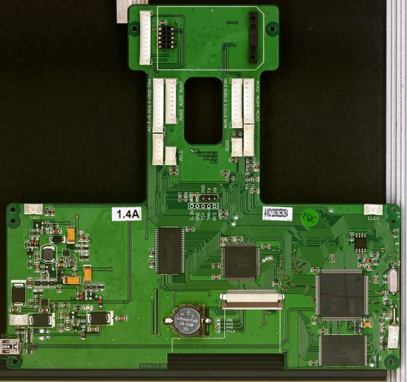

I just disassembled my Devo to make high resolution scans of the front and the back of the main board. If the I/Os are already mapped, please let me know.
It seems to be a simple double layer board with easy traceable routes. I will make the scans tomorrow, and try to scale them down to a reasonable filesize.

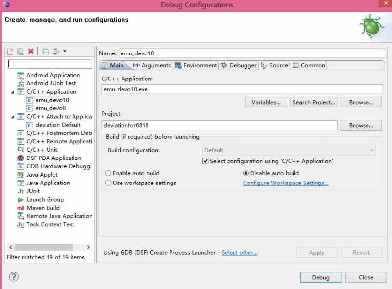

Yes, I am using the Eclipse to write and debug codes. Here are the general steps:
1. Follow guidance in the README/README-OSX to setup cross-compile environment for your OS. I tried the setup for both WINDOWS and MAC OS, there is an issue on builing fltk under Lion Mountain. So eventually, I am doing my debugging in a Windows virtual machine under Mac OS.
2. Once the cross-compiling environment is setting up, type “make" or "make TARGET=emu_devo8 WINDOWS=1" to verify whether it works correctly, if not ,go back to step #1
. Otherwise, make sure to add proper PATH to your OS'
3. Download a Eclipse and install CDT plugin, Google is your best mentor: eclipsebook.in/advanced-eclipse/extendin...ipse/installing-cdt/
deneb.homedns.org/things/?p=113
4. Import the project into the Eclipse: File -> New -> Project -> C/C++ -> Makefile project with Existing Code , hit Next button and then click Browse button to select the deviation Makefile
5. In the Eclipse IDE, create a Debug Configuration under C/C++ Application entry, it should look like below picture.
Frankly speaking, setting up the IDE environment with the Eclipse is not as easy as using the Visual Studio

devo 12s front
edit: it resized the picture on upload and i cant attach the zip file ... any size restrictions?
i try to upload the file on an other way.
edit: the other way: www.sendspace.com/file/as2uoh

Basically, it is very hard to have it build within the Eclipse as the makefile contains Shell commands that the Eclipse can't recognize. So I have the targets built in MingW's command line
However, I am using the Eclipse for writing codes and debug the emu_devo10/8.exe. The Eclipse 's CDT plugin can still improve C++ coding and debugging productivity a lot more than using VIM or other editors

I use windows system with mingw, yagarto toolchain and eclipse with Mercurial, and I can do all (compile, Hg-command, defuse tool calling) within Eclipse per mouse click.
I hope this quick eclipse instruction can help.
What you need:
1. Running toolchain on Mingw Shell (you can compile without toolchain error)
2. Phyton
3. Java Runtime
4. Eclipse with CDT
5. Mercurial v2.0 above ( mercurial.selenic.com/wiki/Download )
6. MercurialEclipse ( mercurialeclipse.eclipselabs.org.codespo...i/update_site/stable )
7. Project and environtment setting
If you did all PB instruction how to install the build environtment, you have done step 1 and 2.
Then just install 3, 4 and 5.
After you have installed Elipse then open it and install plugins MercurialEclipse over Help->Install New Software.
Project import and environtment setting
1. Click File->Import, select Clone Exixting Mercurial Repository, then click next and follow until finish (you can clone in other directory name, just change it to your desire name)
2. Select the project in Project Explorer by clicking it the open File->New->Convert to a C/C++ Projects
3. Choose makefile project and --Other Toolchain--, then click finish
4. Click File->Properties then click C/C++ Build
5. On Builder Settings Tab->Build location add /src before }, example: ${workspace_loc:/deviation/src}, this ist your working directory for this project.
6. On Behavious Tab -> Workbench Build Behavior, Build (Incremental build) put your desire make argument (ex: TARGET=devo10) and clean argument (ex: TARGET=devo10 clean)
7. Explode C/C++ Build then click Environtment add:
PATH -> Your compiler bin path, mingw bin path, msys bin path, python path, mercurial path, and JRE path
example:
PATH D:\compiler\arm\bin;C:\MinGW\bin;C:\MinGW\msys\1.0\bin;C:\Program Files\Python27;C:\Program Files\Mercurial;C:/Program Files/Java/jre6/bin/client;
TEMP -> your temporary directory
TMP -> your temporary directory
8. Now you can build project by right clicking your project->Build project
To do Mercurial command just right clicking your project and choose Team.
What you need next is to configure code style to accomodate nearest PB codestyle
