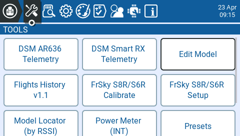

I am flying a lot of Spektrum umx Planes over the dsm2 protocol. Since the latest Version there was a Change in telemetry: via deviationtx there is Always a voltage of 4,2v comming in. This must BE the RX voltage. The very new umx Planes are sending some more Data. So my question: Would it be possible to get the voltage of the battery? This Would be so great!
Thanks in advance
Thanks in advance

Thanks for your superfast reply.
I was searching the web and found that Screen of the edgetx Software.
So the as3x telemetry is working fine, but we need also the newer DSM smart RX telemetry.
Would be so great to have that!
By the way i am using a Devo8s and a Devo12s.
Thank you
Thank you

There at 07:26mins you can See that there are 3 telemetry screens on Spektrum TX for the newer (smart) Planes:
Is there a way to See the full log of every Data the RX is sending?
