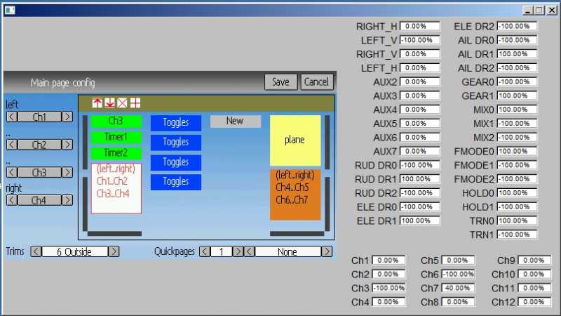

Maybe its intuitive to implement it the following way:
If you select an element, there are buttons (up+down) to create an invisible spaceholder above the selected element to move it up and down
Nach dem auswählen eines Elements auf der der Mainpage Config Seite, erscheinen zwei Tasten (up+down) die einen unsichtbaren größenveränderbaren "Spacer" oberhald des ausgewählten Elements einfügt.
Der Spacer darf sich nur solang vergrössern lassen, bis das Element am unteren Bildschirmrand angekommen ist, und wird am besten auf 0 zurückgesetzt wenn man durch draufklicken auf das nächste Element weiterschaltet, welches ja evtl grösser ist
Dadurch kann man sich die Buttons zum Top and Bottom Alignment sparen
Greetz Wene

So if you want to bottom-align the only small box in a row you will have to click 240 times on "one pixel down"...
I have no concrete idea yet how to realize it best.
03 Jun 2013 14:56 - 03 Jun 2013 15:15 #10524 by Wene001
i think this would be ok because its just used to fine tune the position of some elements. is there a way to jump bigger steps if the down button is long pressed.
maybe its better not to remove the top and bottom alignment.

I have uploaded a new version (82d1ef). This one has spacers as proposed by Wene01, but they are not saved yet (so they are lost when you switch models or power off the tx), but this should be sufficient for testing if they are useful.
The toggle issue is fixed, some pages (esp. tx config page) are redesigned for Devo12.
04 Jun 2013 00:29 - 04 Jun 2013 01:34 #10539 by Pattaya01
Thanks for the upload, tried a bit and I found that if I try to insert a spacer in-between timer 2 and the bar box, it doesn't work. I think there is enough space, but it refused to insert anything. I then removed timer2, pressed the +, a new box appeared. But after clicking 2x on the new box, it vanished and after that, impossible to insert a new box.
Edit: Seems to be a general issue. If I delete an object, insert a new one, click on it 4 times, it disappears and you cannot insert another one anymore.

04 Jun 2013 05:24 #10542 by rbe2012
Yep, confirmed.
If you delete an element (or more) above, the "disappeared" element gets visible again and it gets obvious that it was too big to fit. There is something wrong with calculating the visibility of objects - non-fitting objects are not skipped.
I have worked on this yesterday because the spacers needed some rework. Maybe it was too late to see this bug... I confess I did most of the tests with the 2nd column where not trims are (in my default config).
Sometimes it is sufficient to change the trim type to make the elements visible (e.g. 2*big box, box, new element changed 2 or 3 times (crosses) --> invisible; appear when trims are removed).

I have published a new version (Version_b034b1). The handling of elements is improved now; the issue Pattaya01 mentioned does not occur anymore.

I also don't like these spacers. The idea of shifting every element individually up and down might be the best, but in consequence I will have to store the coordinates of every element. Actually I can calculate them.
It is the old question - memory size or calculating speed.
I fell the time to redraw the screen on the main config page is too long so speeding it up isn't the worst idea.
I think I will give this a try too.

Of Course it would be the best solution to have the option to move each element up and down and store the y coordinates.
No funny spacer elements and intuitive to use.
I would remove the top an bottom alignment to keep it simple.
Bigger steps on long press is all we need i think.
If possible dont redraw the whole screen
Can you change the limit of max 4 toggle elements to 6.
I like it like one complete element ist used each toggle.
switch on position 0 left icon
same switch on position 1 middle icon
same switch on position 2 right icon
This way the position of the icon gives the state of the switch for quicker reading.
BTW I don´t like that the color changes on a selected element.
I think the best way is to draw a red border around the selected element.
Thx again for the great work.
