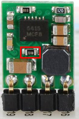

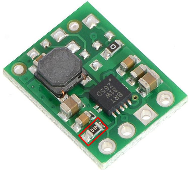

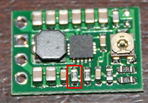

Yes a resistor on the pololu.
On the pololu I used (S7V8A) on the 7e rf modules I had to remove the resistor pictured for the pololu to shut down correctly.
edit. Added picture of Pololu D24V5F5 showing resistor that may need to be removed.
edit. Added picture of Pololu 2562 showing resistor that may need to be removed.
