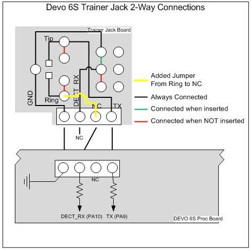

24 Mar 2017 18:27 #60701 by Morlacus
Thanks for your replies.
I am wondering if it would not be possible to use the ring connection of the standard ppm port of the devo 12s (which seems to be the same than the one of the 8s and the 10 and is probably not used for anything.
My idea would be to connect the tx pin of the board of the devo the the ring pin of the 12s ppm board. and use a stereo cable.
Do you think that would work and would there be any danger for the tx ?
Included the shema provided by deal57 (forget the yellow strap)
24 Mar 2017 18:38 - 24 Mar 2017 18:43 #60702 by Moeder
I guess you could, but it doesn't make any sense to me. With the current 12 wiring you could actually use ppm and voice at the same time when the code is updated. I guess we could move ppm output to the UART on the 12 as well and you could rewire your ppm port to reflect the change and have the same functionality as the other devos, but I don't see too many users doing that, as most would prefer preserving ppm usage and adding the dfplayer, as it is as simple as adding a module.
edit: oh, just saw the schematic you attached. Yes, if ring is not connected on the 12, wiring TX there would work just fine. Inside your voice box you can just connect tip and ring then and it should work on all of your devos.

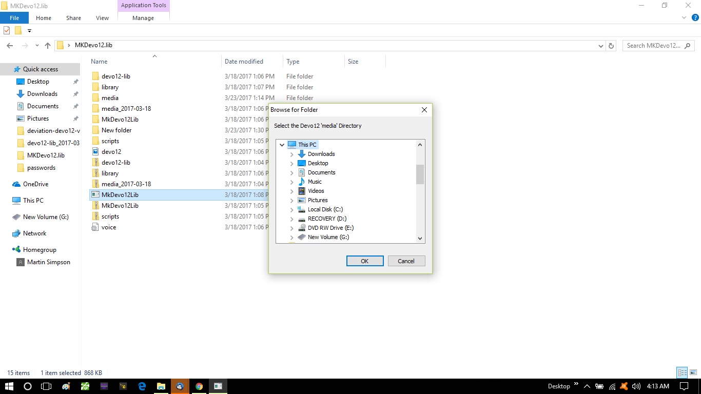

25 Mar 2017 04:39 #60712 by magic_marty
When i try to use the MKdevo tool i select it and it asks to select the media file which i do and then it says it created a lib.dfu in the directory but no file is created so could somebody please tell me what i am doing wrong? I have tried several different ways and it never generates the lib.dfu file..

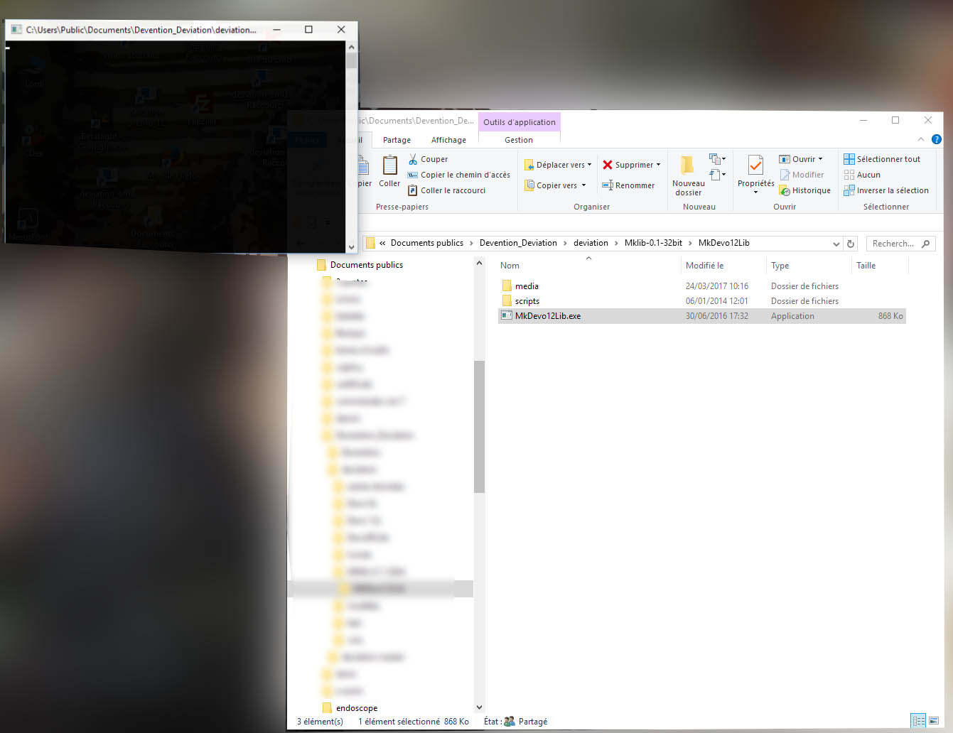

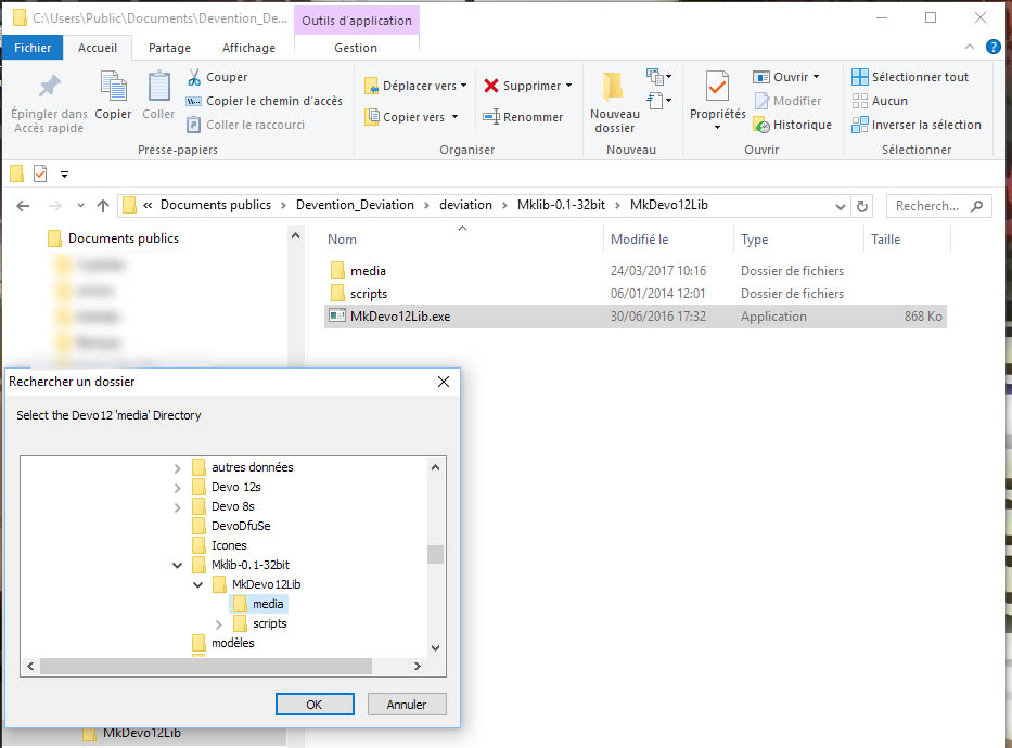

25 Mar 2017 07:34 - 25 Mar 2017 07:38 #60714 by Morlacus
have you read the following post
www.deviationtx.com/forum/custom-skins/2...themers?limitstart=0
For me it works like that
I have in the same directory : The program MkDevo12Lib, the scripts directory and my media directory.
I launch the program. A dos (black) window appears and goes and its done.
There is a warning if the devo12.bmp file is not in the media directory. So keep it and add a copy named backgrnd. bmp.
Edit : I see that the script directory is not included in the download on the forum downloads. It would be good to put it with the program. Could also be included instructions from the first post of PhracturedBlue
I have put the script directory as an attachment in a preceding post.
Last edit: 25 Mar 2017 07:38 by Morlacus.
25 Mar 2017 08:06 - 25 Mar 2017 08:17 #60716 by magic_marty
I don't get any type of black dos window just a small window with all the directories on my laptop and it says to select the media directory the after selecting it a box appears saying it created the library file but nothing is created..

25 Mar 2017 09:56 - 25 Mar 2017 10:55 #60721 by Morlacus
Well if all the necessary stuff is in the same directory (see attachment mklib1.jpg)
if you select the media directory from the browser
and if no dos windows appears (see mklib.jpg)
May be you could try to create the directory direct on the root of your disc - some who had problem try it
After that I have no more ideas:(
EDIT . One more thing : It seems that the name of the directory where you put all necessary files should not have spaces in its name.
Last edit: 25 Mar 2017 10:55 by Morlacus.

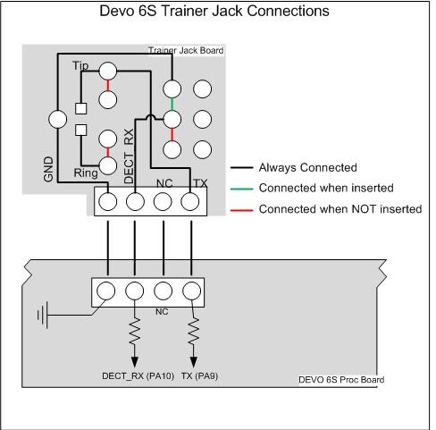

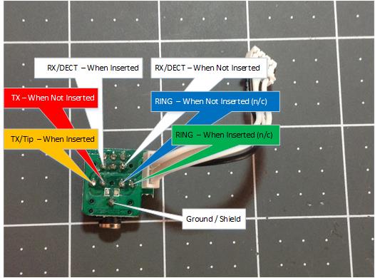

25 Mar 2017 19:56 - 25 Mar 2017 22:07 #60739 by Deal57
Morlacus wrote: Thanks for your replies.
As near as I can tell the Ring pin isn't used for anything. The "stock" wiring is below. The ring isn't connected to anything in the Devo. The Tip is used for TX (from the 6s, 7e, 8s and 10 Devo) and that's what I connect to the RX of the DFPlayer. With or without the strap, the DSC port isn't set up to connect the RX (from the Devo) to anything but Ground. IIUC the stock firmware uses it to detect an external connection.
With some luck I'll get this connected internally in my 12e so I can document the wiring. It uses a different jack.
Last edit: 25 Mar 2017 22:07 by Deal57. Reason: 12E uses different jack.
25 Mar 2017 20:06 #60741 by magic_marty
Morlacus wrote: Well if all the necessary stuff is in the same directory (see attachment mklib1.jpg)
Still no luck i tried putting the media and script files in a separate directory with the MK and it says it generated the lib.dfu but nothing appears so i tried putting the media and script plus the MK directly on the C root drive and still does the same ...Also tried putting them on a external thumb drive and again says generated the file but nothing appears...:(
