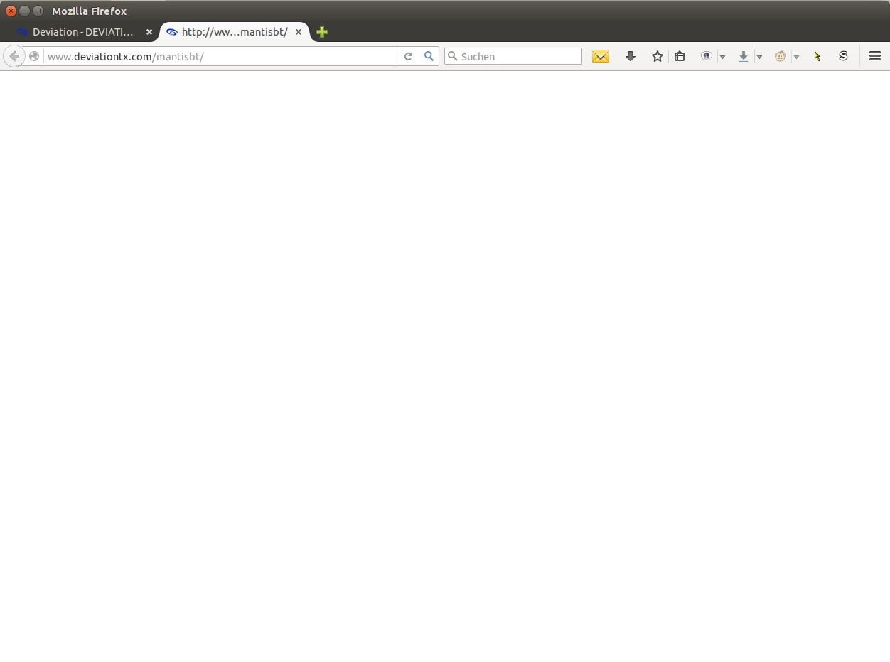

02 Sep 2016 10:29 #53406 by FDR
Replied by FDR on topic Ultimate 7e-256k builds
The bug tracker is out of order at the moment.
...actually for the last two months... :(
