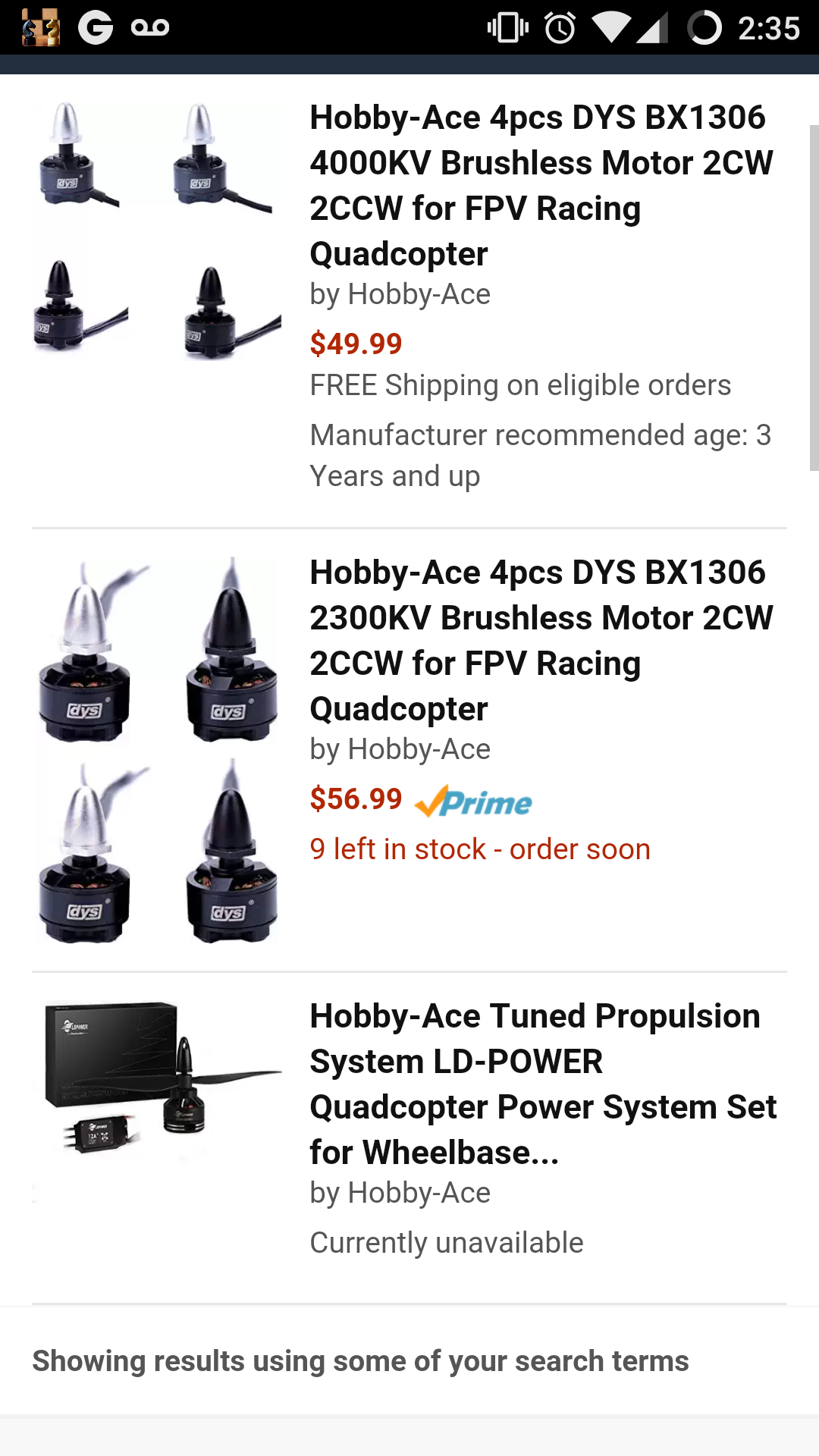

Thank you. I probably would prefer the cheaper fc for budget purposes. Will any of them work with deviation or will I need a separate tx? What about an altitude barometer?
I want brushless. Which of these would you recommend? (Attached). I'm also going to get 20a escs and 3035 3 blade props. What else will I need?
Lastly, can I get a micro GPS in the build as well? Is it recommended?
Thank you for your help!

Yes any of the Flightcontroller will be supported, if using stock Devo with deviation, I would go with a sattelite RX DSMX.
Otherewise Frsky is very good compact sbus receiver, but need cc2500.
For 130mm quad brushless is all very small and pretty stuffed, all the projects Cleanflight, Raceflight, Betaflight etc are inteneded for racing quad only. (not position hold, waypoints etc) For full navigation GPS etc, better to use Pixhawk mini, but I think for such small quad, is not possible to fit all weight and sensors.Then must buld a bigger Quad.
Motors suggested should be fine, kv is the RPM/Volt, so depending on the lipo 2s 3s 4s and indeed power consumption/flight time speed. I would check some other forums on your build, deviation is not the right place to discuss it.
At least deviation Tx is perfectly well suited with any flight controller.
