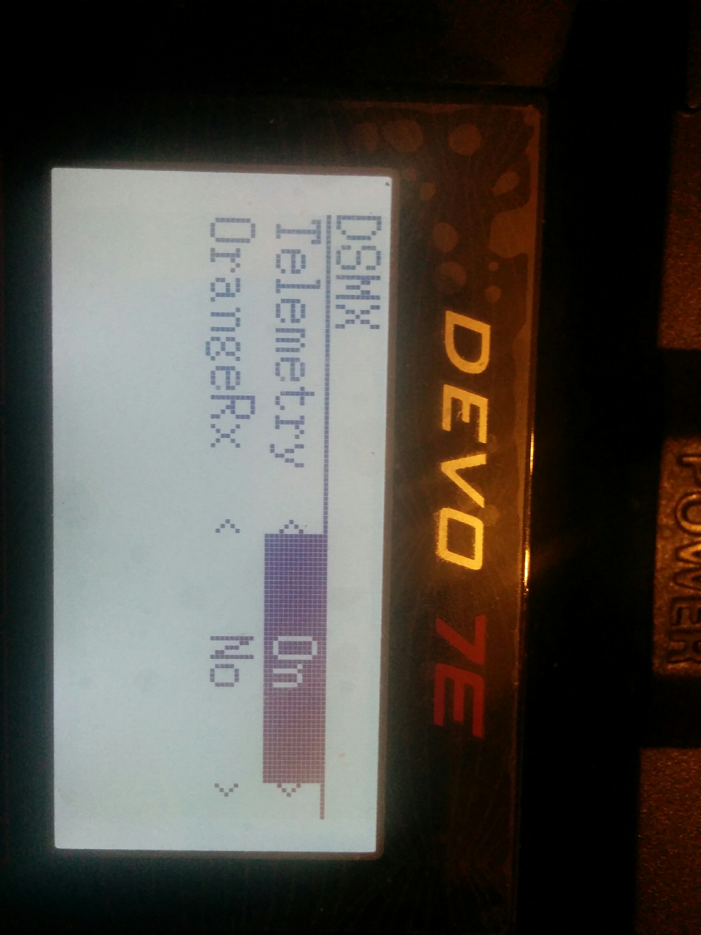

- wolfdale
- Posts: 1
04 Sep 2018 23:52 #70648
by wolfdale
Replied by wolfdale on topic Deviation v5.0.0 build with latest protocols
I tried the emulator for the devo 7e, and the "Fullspeed" option under DSM2/X protocol is present, but on my devo7e I can only enable Telemetry, and OrangeRX options. Is it a memory limitation of the radio? Thanks.
