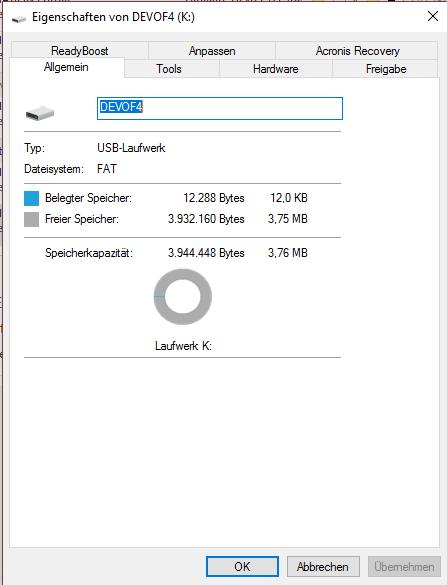

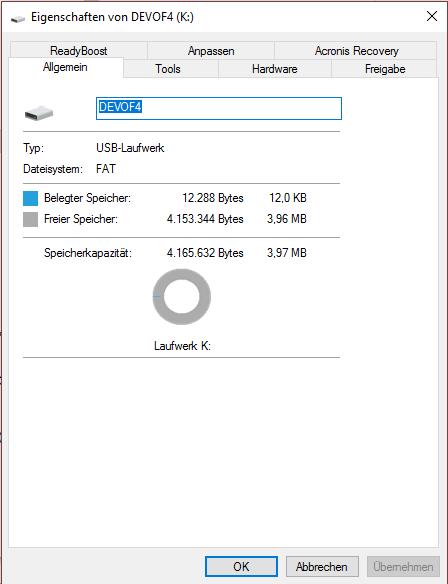

Replied by SirDomsen on topic Ultimate Devo F12E (devof12e-4MB) builds
finally tested the F4 XMS version. Seems to work pretty well! As M8A4X said, flash memory seems to be increased, I can confirm that. Thanks so much for making the F4 worth to have
Best regards
Domsen
Best regards
Domsen

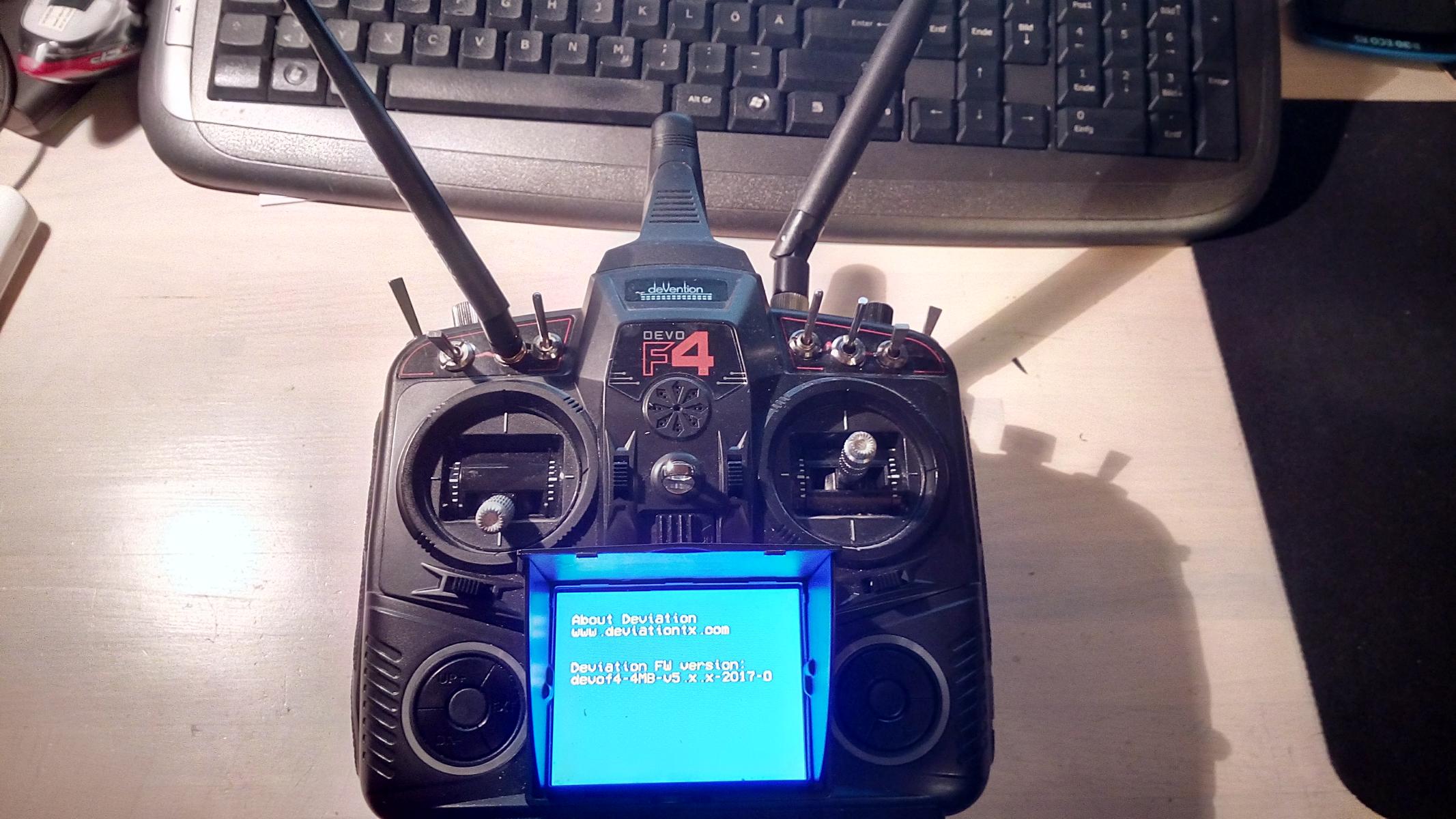

Replied by vlad_vy on topic Ultimate Devo F12E (devof12e-4MB) builds
Thanks, it looks like Devo F4 work fine as well.

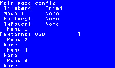

I can add to Devo F series empty quick page for use with external OSD. You can select that page ("External OSD") at "Main page config" menu (for Menu 1, Menu 2, Menu 3 or Menu 4), and switch from main page to OSD page by long press UP or DOWN button (and return back to main page).
What do you think about it?

28 Sep 2017 19:11 - 28 Sep 2017 19:19 #64726
Replied by vlad_vy on topic Ultimate Devo F12E (devof12e-XMS) builds
Last edit: 28 Sep 2017 19:19 by vlad_vy.
29 Sep 2017 03:59 - 20 Oct 2017 04:08 #64733
* Fix Quick Pages, from vladislavy
* Add "External OSD" empty page to Quick Pages, from vladislavy
Test build for DevoF12E-XMS, Devo F7-XMS and Devo F4-XMS, based on Nightly Builds:
Files deleted, see Nightly Builds...
