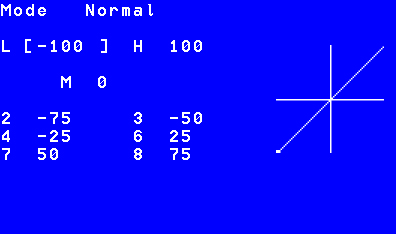

At the moment not done three menu items: "D/R & Exp", "Throttle curves" and "Pitch curves". If you have unmoded Devo F12E or Devo F7, you can test all implemented fixes with today Nightly Build. Do not touch "D/R & Exp" menu item, transmitter will reboot.

I could not find why Mixer GUI "Standard" - "D/R & Expo" page crashes with "text" GUI, though it has the same code with Devo 10, so be careful. Perhaps someone else will be able to fix it.
Other known bug: model "Icon" load/change page doesn't display icon image.

Known bugs:
* Model "Icon" load/change page doesn't display icon image.
* D/R can't be greater 100%, with 102% transmitter freeze and reboot. Probably it can be related to XY-graph.
* At "Throttle curves" and "Pitch curves" pages, value fields for inactive YX-graph points have not any visible highlight or cursor.
